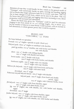

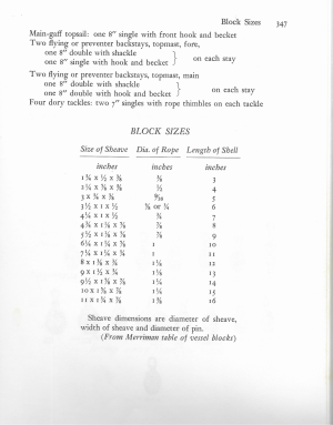

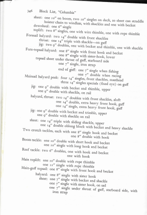

That would be great information. The closest I can think of are the block lists for similar schooners such as Columbia which was only about 2 feet longer than Bluenose, that are published in the American Fishing Schooners book by Chapelle. Once you have the block sizes you can calculate the rope size very easily. It is a pain in the butt book as the chapters are a collection of short writings and are somewhat in alphabetical order and no index so hard to find things. Still, it is an extremely useful book to have if you are building any kind of fishing schooner. For lengths you may need to estimate be running a test piece of rope along the path it will follow on the model.
