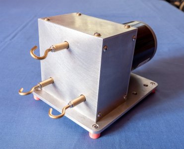

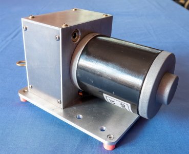

- Main Ropewalk Unit:
- The construction is fully mounted on bearings, ensuring smooth and quiet operation.
- The drive is transmitted via a timing belt and gear system, which guarantees even rotation of the hooks.
- A 120 W electric motor provides stable twisting even under higher loads.
- Three hooks mounted on the shaft are used to attach the threads.

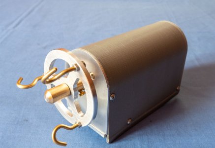

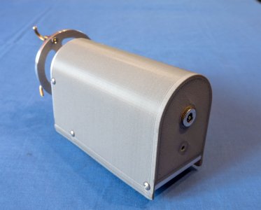

- Carriage with disk (“talerzyk”):
- An independent unit powered by a motor with a reduction gearbox, which ensures slow and uniform movement.
- Equipped with a rotating disk through which the threads pass.
- During operation, the carriage moves along the rope, maintaining tension and ensuring an even twist.

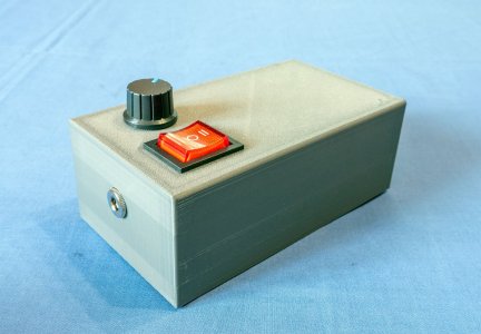

- Control panel:
- Operates alternately with either the main ropewalk unit or the carriage (switching is done by reconnecting the cable).
- Equipped with a main power switch and smooth speed control.
- Power supply:
- External 12 V DC power supply connected to the control panel.
