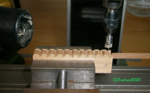

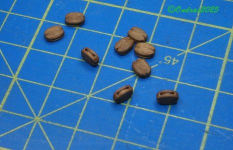

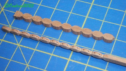

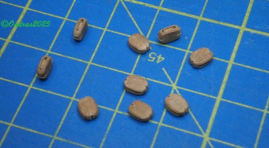

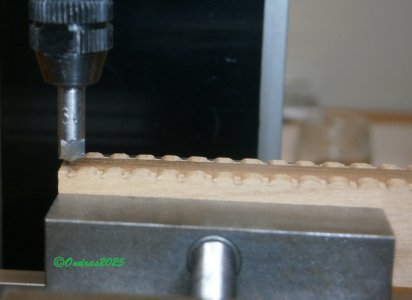

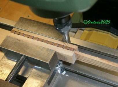

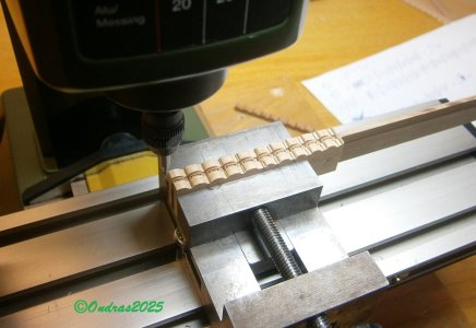

I continue to produce other blocks of smaller dimensions. "Machine" production with shaped cutters..Sleep
waxed..

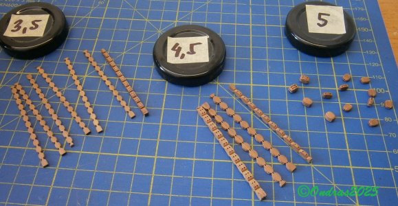

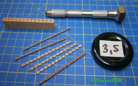

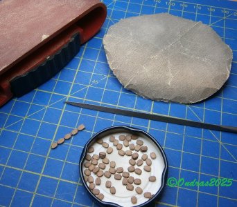

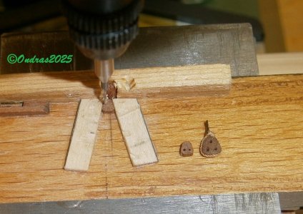

I'm gradually getting smaller and smaller..
There will still be a lot of manual labor here..Explosion
Witaj
Piękne bloczki , gdzie można kupić taki frez Ondrasie . Pozdrawiam Mirek
Hello Mirka. The cutters are homemade, a model maker friend gave them to me. My locksmith was very slow.. Sleep

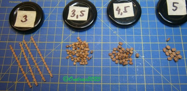

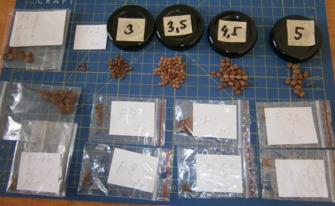

Last batch of 3 mm size..Sleep
Gradual waxing..

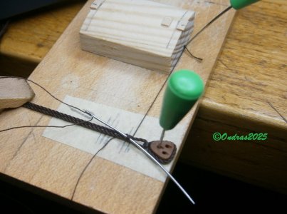

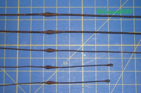

I have been making tackle pulley halters for a long time.
I chose a system of tying and gluing the tapered ends of the cables.. Sleep

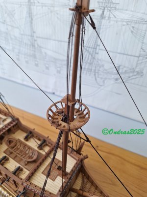

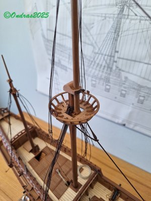

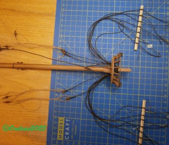

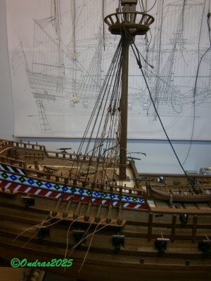

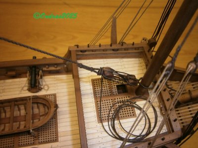

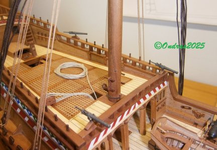

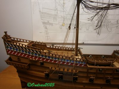

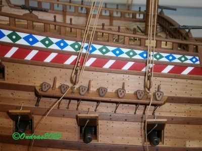

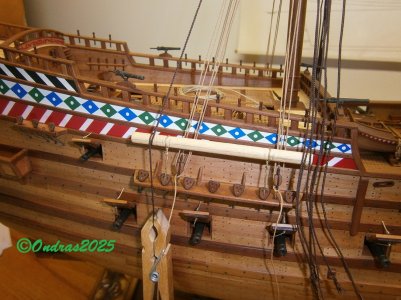

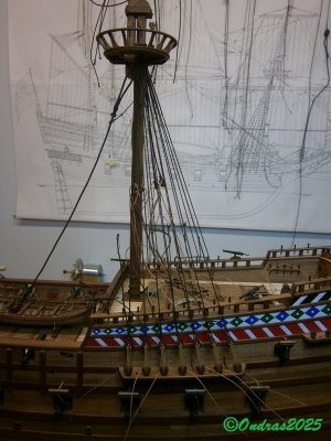

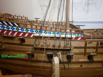

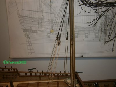

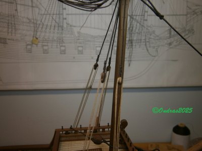

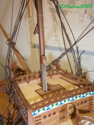

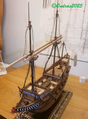

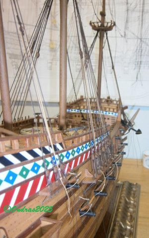

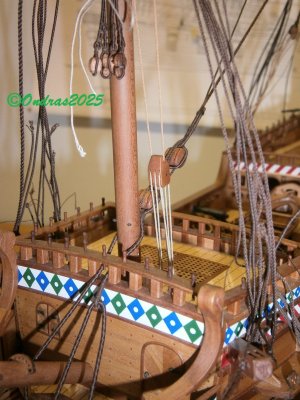

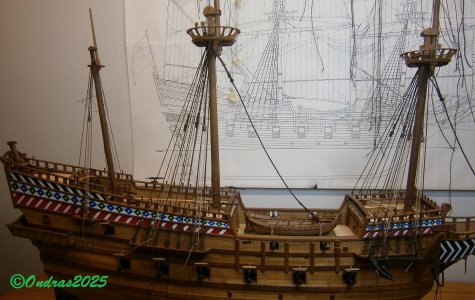

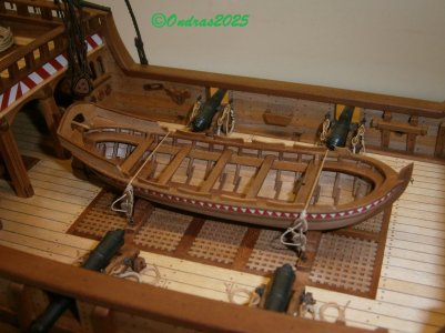

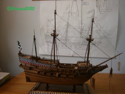

I've made some progress on the boat. Front and main tackle finished, I'm tuning the Stays and the Schrouds are waiting for me..Thumbs-Up

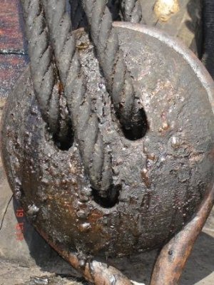

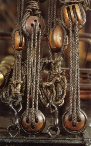

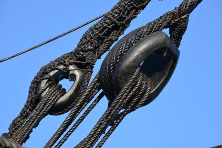

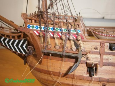

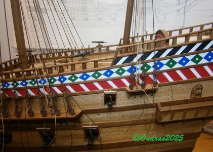

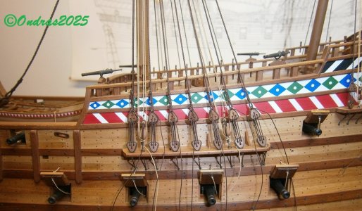

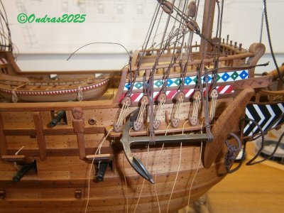

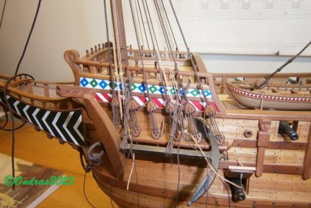

Dear Ondras! The turnbuckles in the deadeyes should be the same color as the shrouds and stays. Your shrouds and stays are black, so the turnbuckles should be black too. You've already done this on the stays. The thing is, after the shrouds and stays were installed, they were carefully coated with resin, along with the deadeyes.
If the shrouds are tarred but the turnbuckles are left untarred, the structure will still collapse under the influence of water.
1-2 (2).jpg 5XImJm6i2ak.jpg 0HJJwThigtSzgQswDAx6UsVJkIp8eITom_SdaL971DiBSP67b9nGT5a13req2b3m5sK0UeuLz4zoNEChujdkMuwf.jpg 6422159 (1).jpg
View attachment 547171 View attachment 547172 View attachment 547170 View attachment 547173
Hello iutar. The light ropes are just for measuring, the dark ones will be placed in the end. But thank you for the timely response, it is often needed..Thumbsup

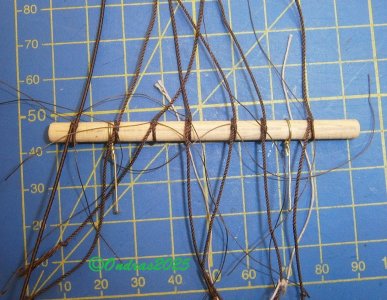

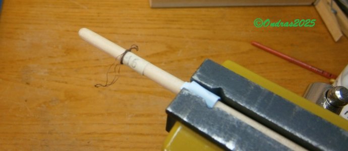

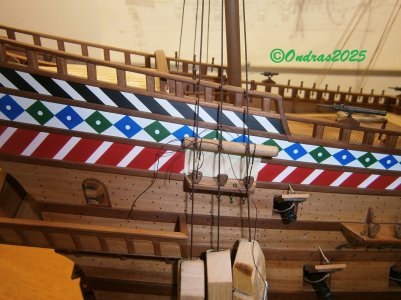

I tied the block that holds the front yard. The tie is right next to the main stay pulley..

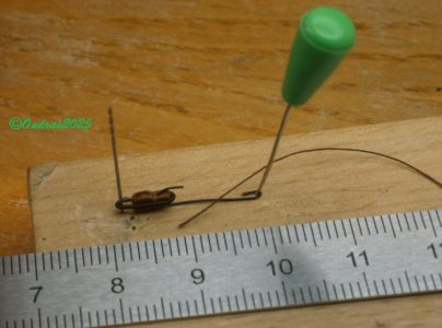

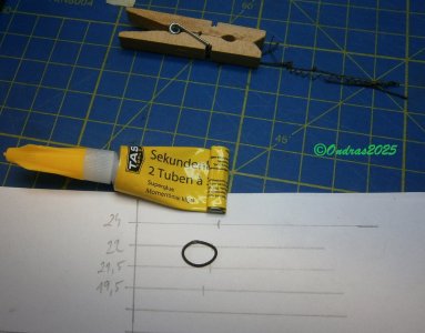

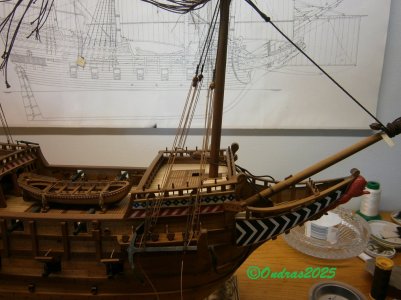

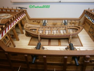

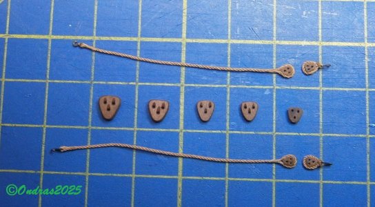

Before gluing the masts, I tied the boat back, as I was advised on another forum. I put in a thicker rope and made smaller deadeyes straight away..Thumbs-Up
All sizes created by me..

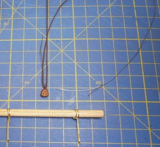

Deadeyes of the foremast measured..
