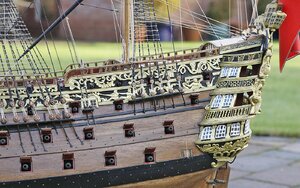

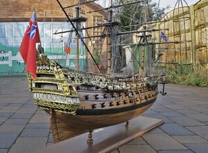

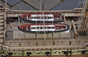

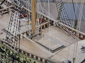

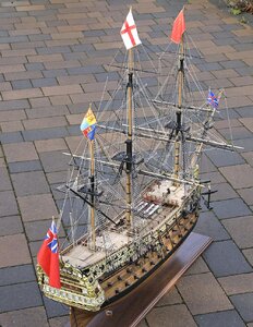

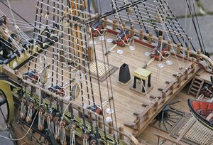

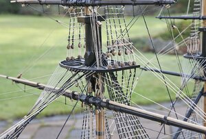

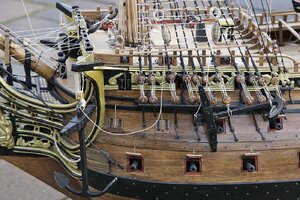

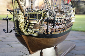

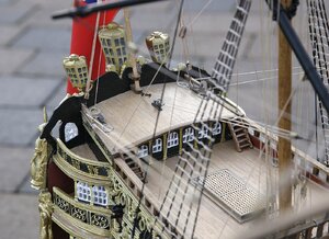

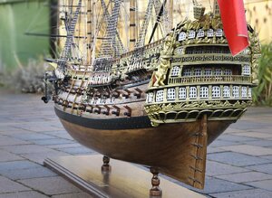

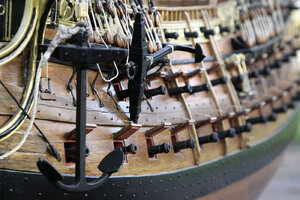

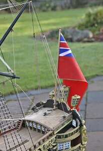

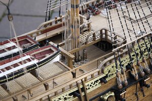

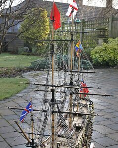

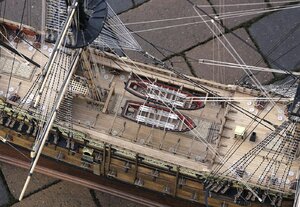

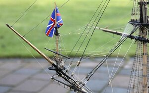

Hi, I’d like to share with you some pictures of a model that I completed a couple of years ago, it is the Royal William made from a kit by Euromodel. I rather jumped in at the deep end making this model, I hadn’t previously built anything large or very challenging, my previous and most difficult model to date had been HMS Fly but I felt that I had it in me to build this kit. It was not a kit as I knew them to be but rather a box of wood and plans to make most parts your self, I would describe it as a semi scratch build but with superb castings. It was a very steep but interesting learning curve which I think has now stood me in good stead for this hobby. A group of experienced modellers were posting there build logs of this kit on another site, I joined in adding my own build log and in doing so I received a great deal of help and encouragement from the other members.

A beautiful model, I will be adding this to my Contributors Gallery. If I may ask a question. What are you using for the Trenails for the upper planking (that looks dark) and then the Trenails for Wales (that looks bright). Thank you. I love the effect it shows very realistic.

with regard to the tree nails, I used brass nails for the wales, I darkened them first then painted over them when I painted the Wales using a dull black. The deck nails are a cheat really, I just drilled holes for them, .8 mm and rubbed some coloured wood filler in, when sanded and varnished you can’t tell they aren’t the real thing. I put sanding sealer on first so that the planks don’t absorb any of the fillers dye.The filler doesn’t need to be dark as it’s like wood end grain and darkens when varnished, I also use this filler for subtly showing caulking. I don’t know if you can get it in Aus but I use a brand called Brummer, its great, it goes on like a paste, sands easily like a hard chalk and comes in about ten wood shades. As with everything, test it out first. Ken

I cannot get your William out of my mind and particularly if I understand it as a first build. Do you have any idea of the number of hours that you put into this build. Did you do any of the work using milling machines or was it all hand done . . . or somewhere between?

Thanks for your very kind comments they are very much appreciate. No, this wasn’t my first build, I’d done three others previously, my HMS Fly which is in the gallery here was my previous one. All the work was hand done and it took about 1500 - 1800 hours of very intensive but enjoyable labour.

Hi Brian, Well done yourself for taking on this model. like yourself I didn’t like the heavy casting of the windows so a I so I and filed them out and filled them with clear glue. This was the most tedious and worst part of the build and my fingers were sore for weeks afterwards.
