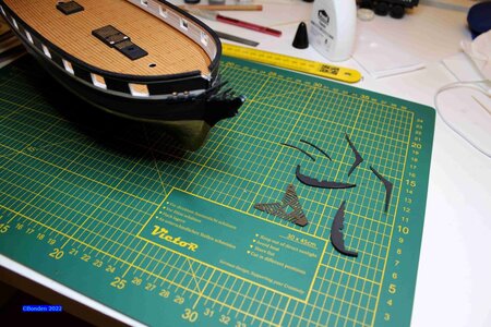

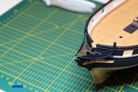

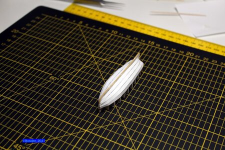

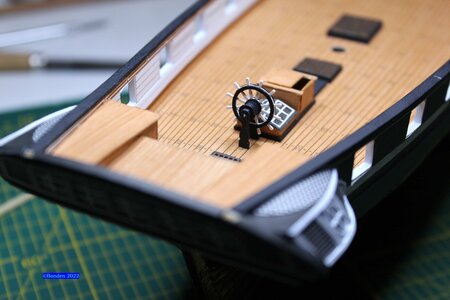

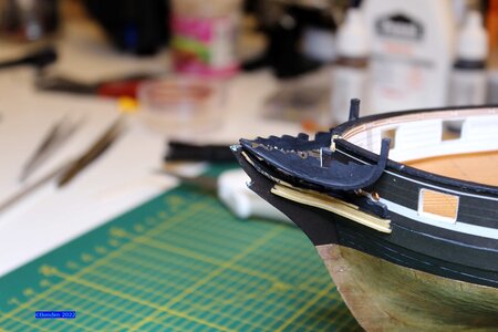

The deck gradually fills up. Then I started building the second dinghy. In the process, I realised that I had made mistakes with the first boat. I should have reinforced the frames beforehand, so I glued them to stronger cardboard before cutting them out. That's why I'm now building the first boat again. You can see it in the pictures - I already like the smaller boat better than the older big one at this point. I think the new big boat will be better too.
View attachment 287797View attachment 287798View attachment 287799View attachment 287800View attachment 287801View attachment 287802

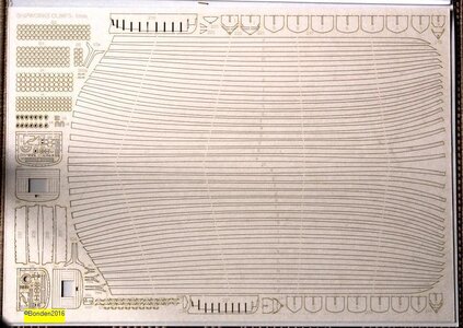

I have started a new project. It is the Russian brig Olimp, a kit from the Russian company Shipworks, in 1/96 scale.
The kit looks really good, the building instructions are very well illustrated, especially for the rigging.

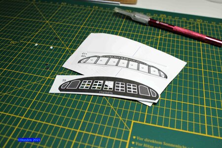

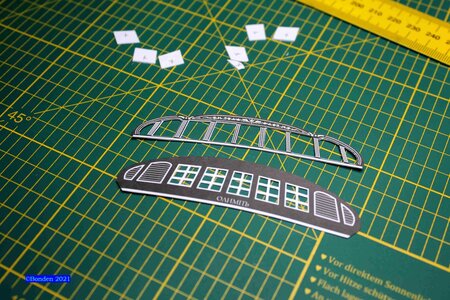

Some of the parts are laser cut, the rest have to be cut out.

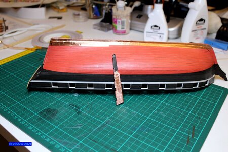

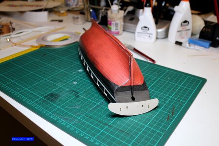

I have already finished the hull. For the underwater hull, the kit provides red paint. This looks funny and is certainly to represent the copper plating. Therefore, I bought copper foil and copper the hull.
After the first layer with planks I putty and sanded. The planks of the second layer had to be cut out. They also fit very well. I painted the hull with acrylic paint before coppering. This allows individual copper plates to come off well if they need to be corrected.
View attachment 262912View attachment 262913View attachment 262914View attachment 262915View attachment 262916View attachment 262917View attachment 262918View attachment 262919View attachment 262920View attachment 262921View attachment 262922View attachment 262923View attachment 262924View attachment 262925View attachment 262926View attachment 262927View attachment 262929View attachment 262930View attachment 262931View attachment 262932View attachment 262933View attachment 262934View attachment 262935
