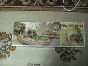

Säo Miguel XVI Century Armed Portugese Merchantman Kit Mamoli MV 21
Charles QC
Well-Known Member
Aug 16, 2019
683
343
Scale 1:54
Length 843mm
Height 630mm
2 full 1:1 drawing
13 sheets of drawing and instruction
Three-masted caraque Length of the ship 35m Height 30m. The period engravings and the historical documents of the naval museum of Barcelona have allowed the reconstruction of the plans of a ship which is placed for the lines between the medieval merchant ship and the galleon, classifiable for the particular structure of the forecastle of front and rear among the carracks. A ship of this type probably participated in Cortez's expedition to conquer Mexico. The external galleries one of which with balcony. The apartments under the aft deck and deck superstructures that provide for the installation of tent to protect from the sun are obvious signs of their use for high-ranking passenger transportation
Ok I am in the deep s*****t (trouble)
Let me explain
My Minister of the Interior has chosen Säo Miguel de Mamoli as his personal ship that I must do for her.
I buy the kit in 2013 and we are in 2019 not done and not started
And I announce the construction of Syren say that it does not go too well and I have an ultimatum she wants her boat
Ok compromise I'll have to do the 2 in parallel
