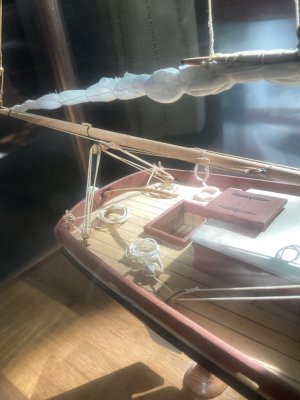

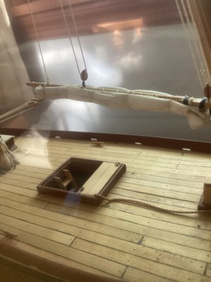

Model Shipways used to sell a lightweight tightly woven fabric called “balloon cloth.” It was used for sailboat spinnakers and possibly military balloons . It appears to be no longer available. I had some that I used for furled sails on a model. Photos below. If this is what Dave is selling, it’s. Probably the best fabric you can find.
NoteIMG_0148.jpegIMG_0152.jpeg that Rice Paper is closest. This is the reason that modelers today are using a similar material- Silkspan.
