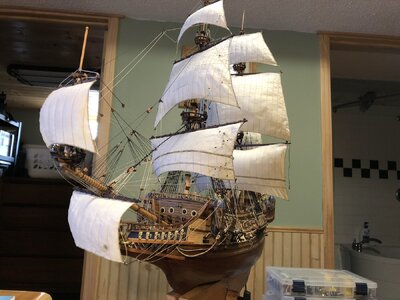

An interesting thread. Not to hijack it, but the longstanding debate about sails on ship models comes to mind. Traditionalists argue that it is improper to have sails on a model that shows the underbody; sails are only proper on a waterline model. The reasoning is that, in the real world, you can never see both sails and underbody.
I can understand that perspective because it is the more traditional style in displaying a ship model, but another idea is that a ship appears complete with all the rigging, sails and hull with everything showing. This is how I chose my first model. It's a matter of preference. The downside is that the sails make it harder to see some of the deck details, but since my model is displayed in a standalone case which you can walk around 360 degrees, that problem is reduced a bit.
