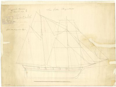

Thank you so much for your reply. I had identified some of the sails, but got confused with the jibs and fore staysails.First, there is no such thing as positive identification; nautical terminology varies by locality and by era. Also, the rigging of any individual vessel, including the arrangement of the pin rails, is subject to the preferences of the master and the boatswain. But here's my try, from fore to aft and bottom to top.
Fair winds!
- flying jib
- jib
- fore topmast staysail
- fore staysail
- fore course (foresail)
- fore topsail
- fore topgallant sail
- gaff foresail
- main topmast staysail
- (gaff) mainsail
- main gaff topsail

AGREE TOTALY-CAPIFirst, there is no such thing as positive identification; nautical terminology varies by locality and by era. Also, the rigging of any individual vessel, including the arrangement of the pin rails, is subject to the preferences of the master and the boatswain. But here's my try, from fore to aft and bottom to top.
Fair winds!
- flying jib
- jib
- fore staysail
- fore topsail
- gaff foresail
- (gaff) mainsail
- main gaff topsail
