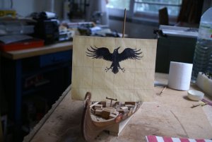

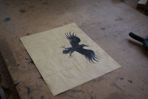

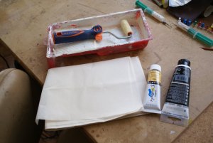

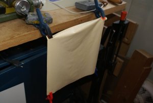

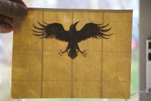

Silkspan is made of a paper much like a teabag paper, which I assume will eventually age, yellow, and crack.
Purser Dave
Sorry, but no it will not! If treated with acrylic like the video explains here:
there is no reason to age or yellor or crack, since it is protected by the paint.
Besides, I feel it more scale like than the tissue normally used.
80187 80188
I used silkspan a lot on model airplanes and some of them are more than 50 years old and still fine.
Regards
JL
