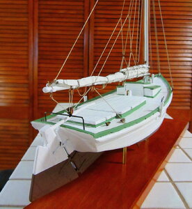

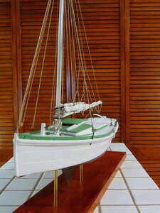

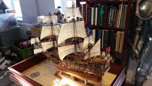

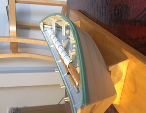

Tom Lauria has a three part you tube series "Making Ship Model Sails from Silkspan" which are step by step tutorials. I made sails following his procedures.
One is a sail for a Grand Banks dory and the second on a Chesapeake Bay Flattie model. Both are shown and the sails are furled or rolled, You can draw on all the sail details (seamed panels, reinforcements, reef patches, etc.) I used a mechanical pencil. There are a number of steps you have to follow but its a fairly simple process. Making a flown sail, which he demonstrates for a simple Beetle Cat sail, is more difficult. He's a professional model builder, I think,; I'd never attempt one. I like the results I got. Some model shops are having trouble getting silkspan these days. I got more last year from www.easybuiltmodels.com

When constructing sails for a full rig model you need to add stiffeners to help shape the sails. These can include sewn cross seams and edges. Around the edges add a thin wire into the edge seam overlap along with the rigging rope. Once complete the sail can be shaped with the wire. Helps keep the sails from looking droopy as in a doldrums. Bob Hunt has a mini practicum on making sails on Lauckstreetshipyard.com.

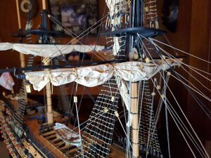

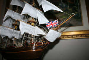

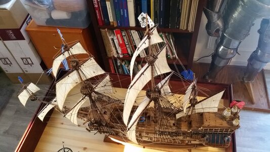

With my first build (HMS Bounty - Constructo) I placed thin wire along the edge of each sail so that I was able to shape the sail to resemble catching the wind. You do not see the wire. I overlapped the edge of the sail to cover the wire and then sewed the overlap to the body of the sail. For my eyes it enhanced the appearance of the model providing a more realistic view of the ship under full sail.
Building the San Lidefonso (Occre) and I plan to do the same with her sails.IMG_0003 (2).JPGnow and plan to do the same with her sails.
