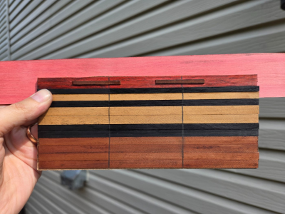

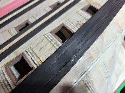

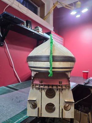

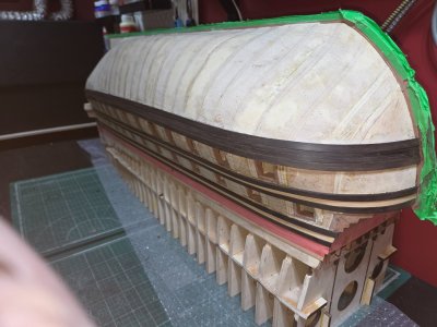

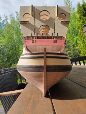

An interesting color scheme, but I think bitumen will do its magic. Excellent as always! Waiting for the planking.
I see a cnc machine on the horizon.Wow! I've been worried how I will fabricate these details and here you go and do it without issue...

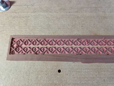

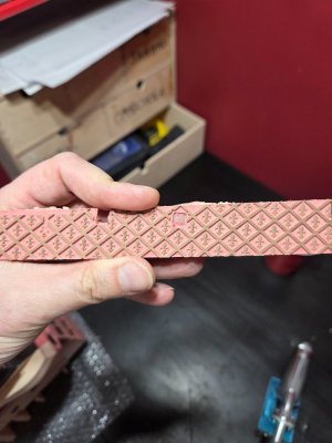

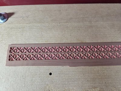

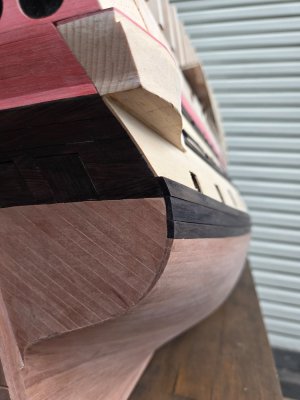

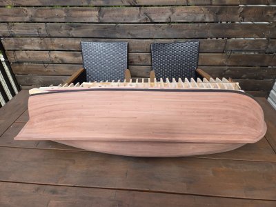

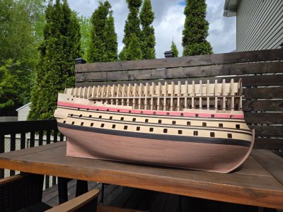

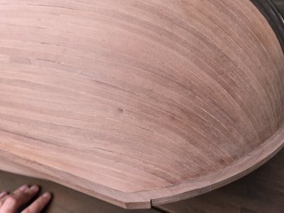

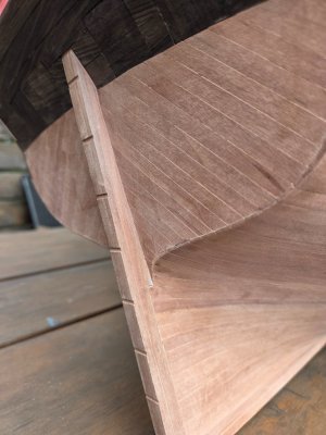

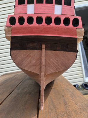

Hi Oleg, just PVA between the two layers?And this is milling of a double layered sheet
View attachment 581550View attachment 581551View attachment 581552
Hi. Nice work. What cutters did you use? Could you please share the dimensions?And this is milling of a double layered sheet
Yep, just pva glue and I clamp the parts betweed two big thick boards during dryingHi Oleg, just PVA between the two layers?
Would be afraid the glue is giving way during the milling, but the result is very convincing.
The final pass was done with conical 2-flute bit R0.25mm, 10deg total angle. 0.12mm between passesHi. Nice work. What cutters did you use? Could you please share the dimensions?

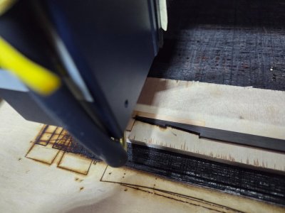

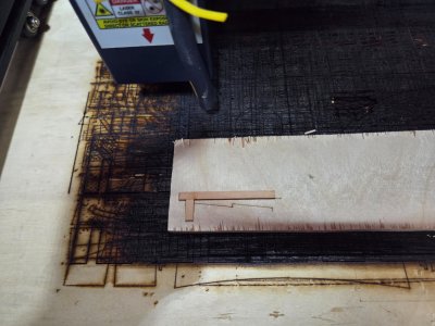

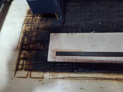

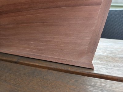

HI. Is it a diode laser? What power is the laser?Doing the scarf cuts on the whales
