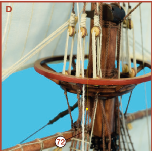

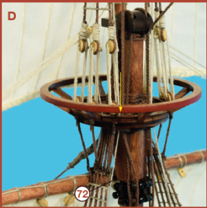

Please help with rigging of this sail
The beloved Ships in Scale Magazine is back and charting a new course for 2026! Discover new skills, new techniques, and new inspirations in every issue. NOTE THAT OUR FIRST ISSUE WILL BE JAN/FEB 2026 |
Is this for the AL kit of the San Francisco and what specifically are you looking for? Rope sizes, block sizes and types, belaying points, ????? Are you also looking for the rigging of the fore topsail yard as well as the sail? There are 8 pages describing the rigging for the foretopsail yard in The Rigging of Ships in the Day of the Spritsail Topmast by Anderson that would be helpful. Lees' book on rigging might help but it there may be differences as it is based on rigging of English ships of war. Anderson's book can be found for as little as US$13 so maybe a good small investment for now and the future.Please help with rigging of this sail
Running rigging of the clew lines run from the blocks at the lower outboard corners of the sail, up to blocks on the yardarm, then through the top just inside of the top's railing, before going down to the belaying points. They does not pass through the shrouds and ratlines, but rather aft of the shrouds.
The running rigging for the lifts, which support the outboard tips of the yardarm, run closer to the mast through the crosstree of the top and downward, inboard of the shrouds, and to the belaying points.
