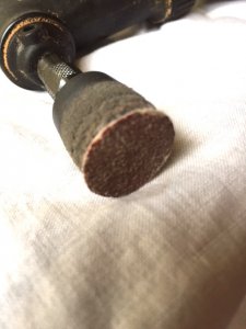

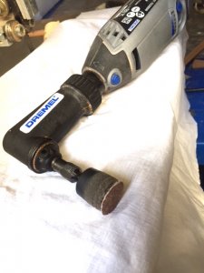

Sandpaper pad holder for Dremel tool.
  • Thread starter Thread starter Bryian
  • Watchers Watchers 4

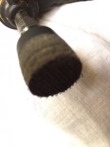

This I did in the past.....and glueing the sandpaper with double sided adhesive tape to the pad.
The problem is, that the tape is very sensitive to the friction heat during sanding

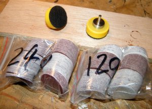

you need the hook and loop type sandpaper so it peels off the disc Uwe.
Even that paper will fly off if the speed of the power tool is too fast.
