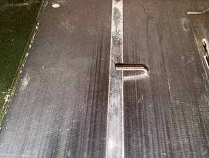

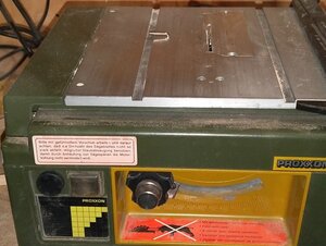

I have two saws Brian, one is the old Proxxon with Variable speed control, and it has a steel pin that is bent to stop it slipping through the saw table,
see pic below,
This is the pin supplied with the Proxxon, it goes right through the shaft to lock it while changing the blade,
and a close up,

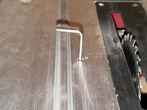

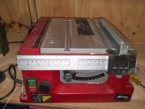

I also have the Chinese copy and it also has a hole through the saw table, but the pin does not go right through
the shaft, it just locates in a small hole in the shaft, again see pics below
Shows the pin locking the shaft,
and a close up, I only paid AUD $290 for this saw and I think it is nearly as good as the Proxxon,
