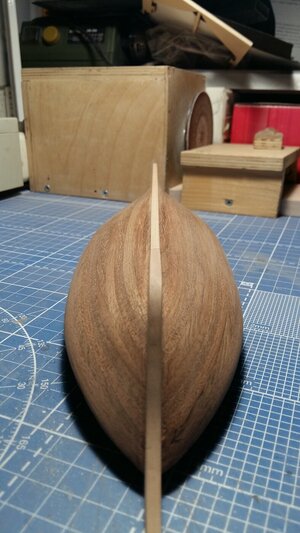

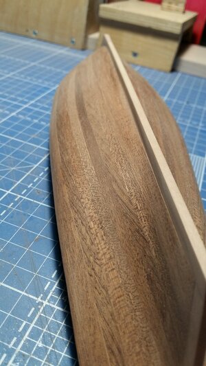

Привет всем. Если модераторы форума не против, открою другую стройку. Это шхуна «Альбатрос».View attachment 229967

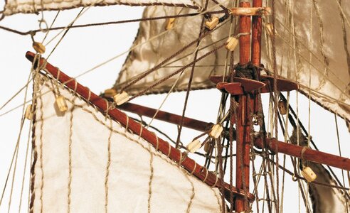

I build this ship about 20 years ago. Not 6that difficult to Build, but more a good training build with the sails and Rigning

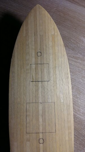

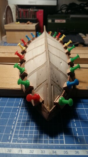

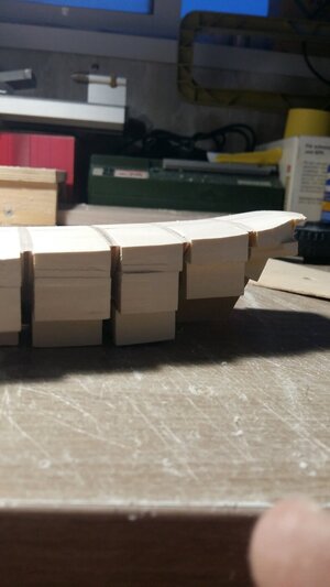

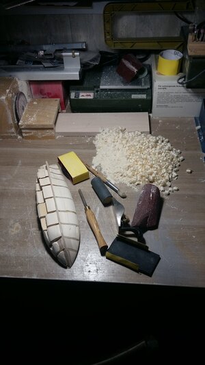

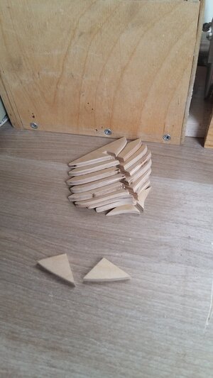

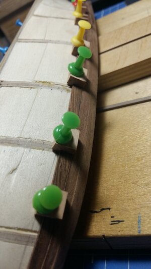

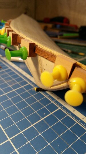

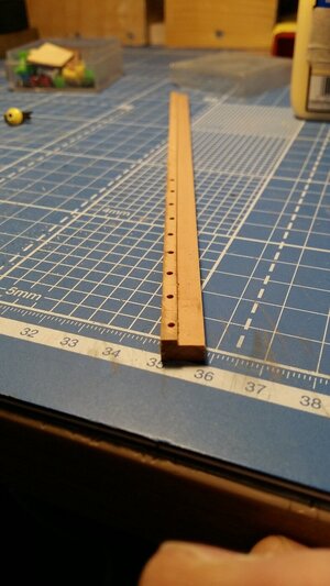

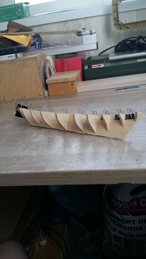

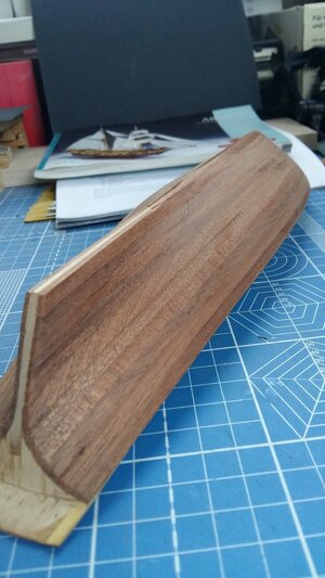

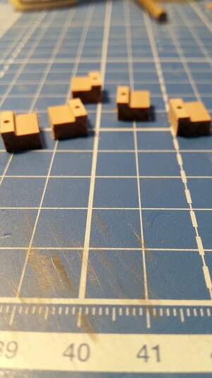

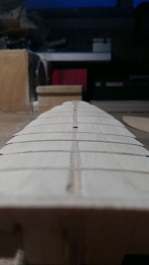

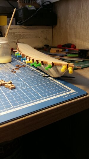

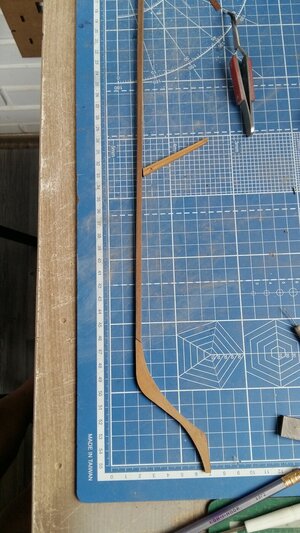

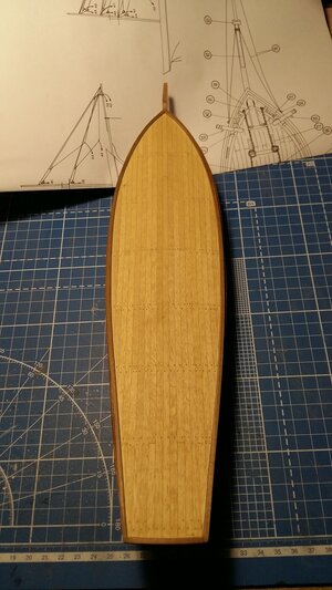

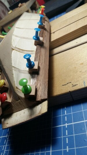

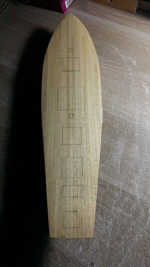

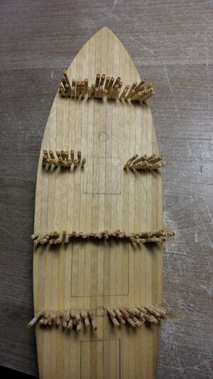

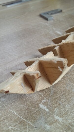

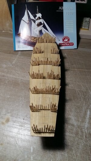

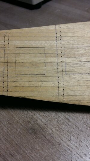

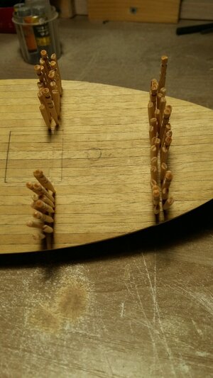

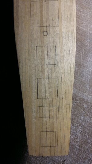

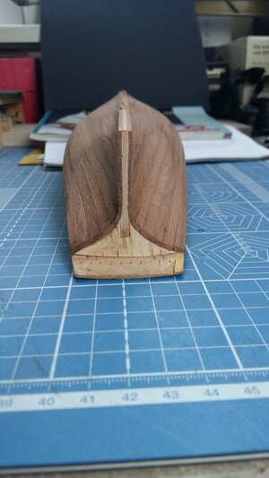

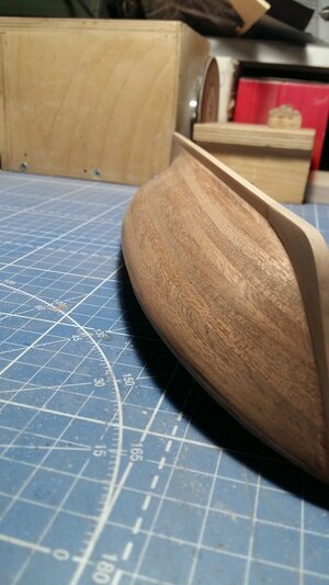

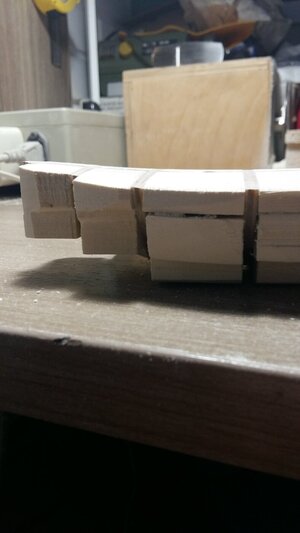

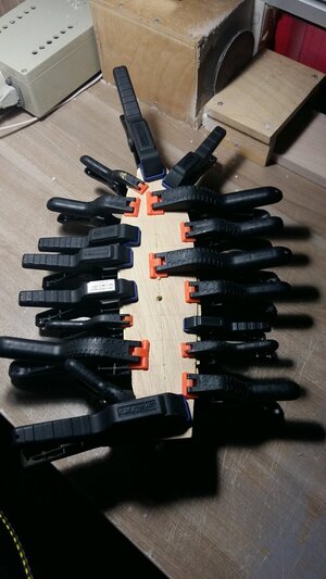

Приступил к отделке корпуса. Прутки в наборе имеют толщину 1,5 мм, поэтому пришлось сделать хомуты. Конструкция проста: приклеил 2 рейки толщиной 5 мм и 1,5 мм, просверлил отверстие под пуговицу и разрезал на части. Такой хомут не портит накладку и надежно ее удерживает.20210424_182503.jpg20210424_182452.jpg20210424_182521.jpg20210424_182543.jpg20210427_200905.jpg20210427_200931.jpg20210427_200944.jpg
На этом пока все. Строительство продолжается. Комментарии, комментарии и практические советы приветствуются автором строительной площадки.

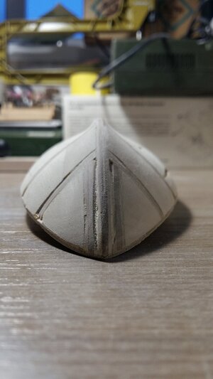

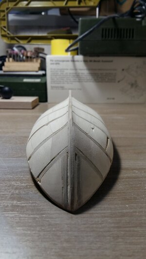

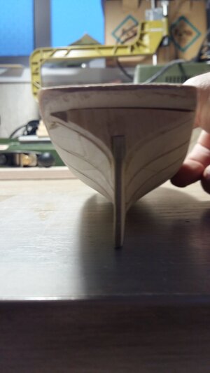

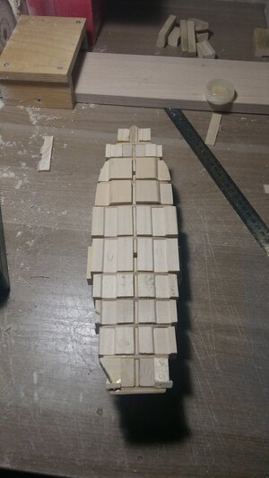

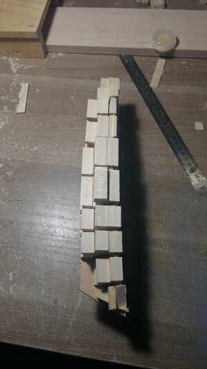

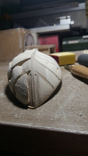

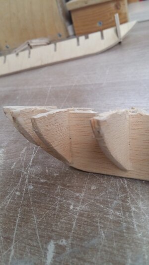

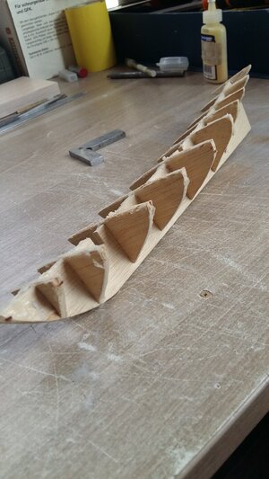

Dear Mr. xxxxxx, I have been through your build - until now - of one of the models I build maybe about 20 Years ago of "Albatross" and you have greatly surprised me, with your way of building.
You not only made Bow- and Stern Fillers, but the hole Hull. I have only seen that two times before. Solly from the Management made a frigate with the hole filled out. He used a special type of filling- Chemical ??- His build is here on the list. The other one is Wirek from Poland -building Montanes - another ex build of mine. He too is making a wonder out of a Kit.
In the beginning, I was a little afraid, as I saw the wood was cut very rough, but then with the filling, it is SUPER You have done the filling the hard way with a lot of work afterward.
Your way to add a gimmick. to set the Planks correctly -the Viking way -which will lay the planks correctly to the hull

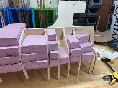

Mostrar más the 1Th image is the one Solly did. The Sponge is a very special one from a flower shop. It sucks up a big amount of a mix of water and carpenter Glue. after an hour un the mix- be careful wife not at home- you add into the baking oven 100-120 ºcontill very dry. it is now stonehard, but can be cut with an electric saw
