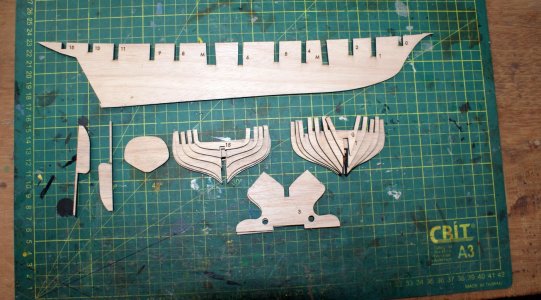

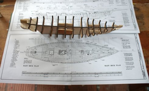

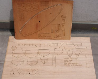

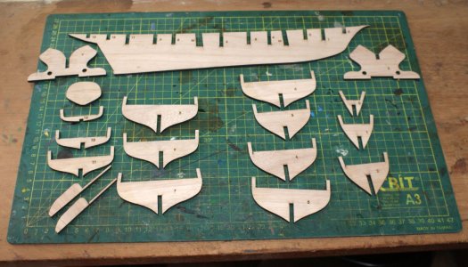

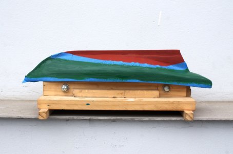

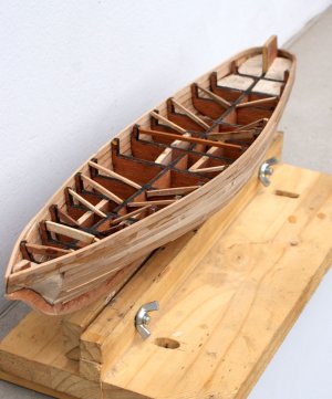

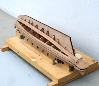

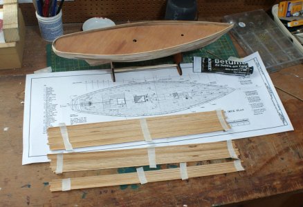

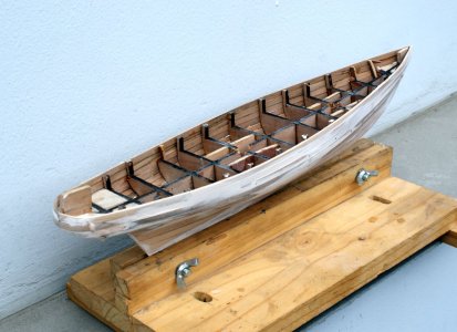

The sections for the frames, the shape of the deck and the dimensions of the masts were obtained from the plans shown and from the hull lines. The frames and main parts were drawn in AutoCAD and laser cut from 4 mm and 1.5 mm plywood sheets. The dimensions of minor elements were taken to the scale of the HAER project plans and photographs.

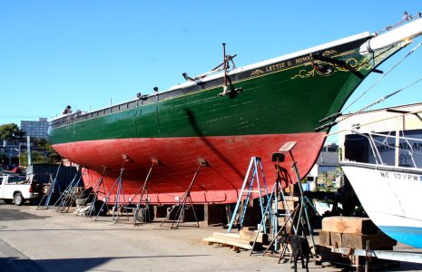

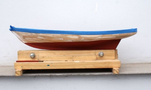

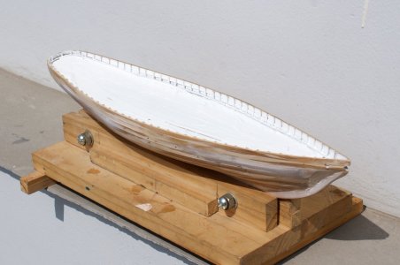

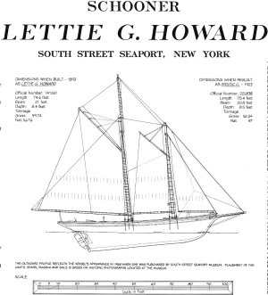

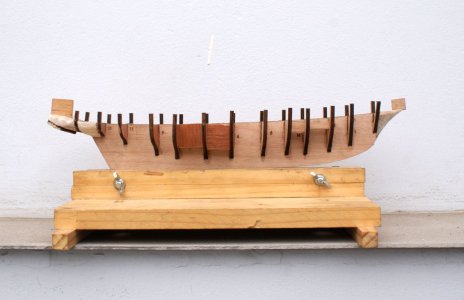

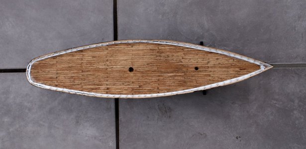

The first photos show the LETTIE G. HOWARD sailing as a training ship and undergoing repair work in port. The third photo is the general view as it appears on the shape survey plans. The following photos show the laser cut plywood sheets from the shape drawings and the first part of the frame assembly. After confirming the alignment, balsa wood fillers were placed in the bow and stern to enable the hull to be given the proper shape. 2x5 mm planks were placed on the hull and sanded to give the hull a smooth shape.

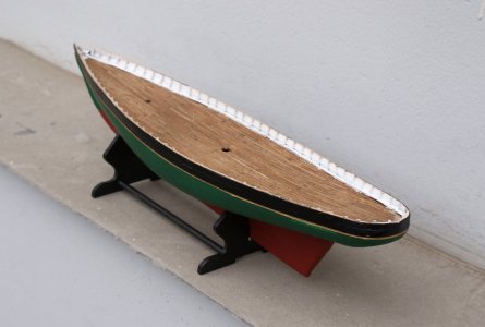

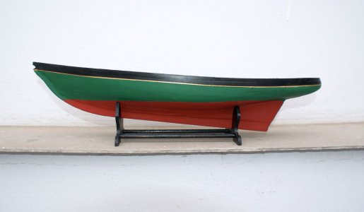

For sealing, a mixture of putty, shavings and white glue was prepared, filling the joints and deficiencies in the lining; it was then carefully sanded with 100, 150 and 200 grit sandpaper and sealed with a diluted lacquer to stabilize the seal. The shape of the deck had to be rectified due to small differences in its width. The planking was formed with 0.6x3x80 mm strips cut from a capirona veneer, a semi-reddish wood, the edges were blackened and glued in an arrangement of 2 instead of as shown in the plans where no arrangement is seen, the nailing was simulated by sanding afterwards and the surface was darkened with Judea bitumen. The edges were rectified by gluing them on the frames. The entire area was provisionally covered with tape before painting the hull.

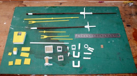

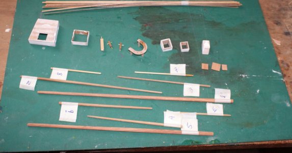

The 1x4 mm sidewall was prepared and fixed and the 1.5x1.5 mm rails were installed, painting everything white. After sealing the hull with lacquer, the entire surface was lightly sanded and the topsides were painted with several layers of ochre-coloured acrylic paint and the bottom with dark green and black; a thin gold stripe was painted between the green and black. The deck elements were then prepared, such as the entrance to the hold, winches, rudder box and bitts; white was used on the sides and dark yellow on the tops. Their position was measured and they were fixed to the deck with white glue.
The dimensions of the sails were taken, prepared with tissue paper painted on both sides with two layers of white acrylic; the seams were simulated with lines drawn in pencil. The edges of the sails were reinforced with cotton thread. The masts, gaffs, booms, and other elements were made by tapering them to hard wood rods. They were painted in a color similar to that of the present ship, that is, dark walnut and white on the masts, dark yellow on the gaffs and booms.
