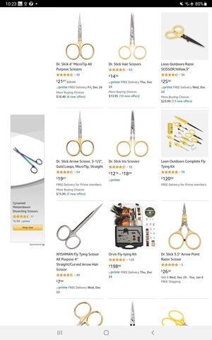

You can find sharp, superior scissors at fly shops where they sell materials and tools for fly fishing. Usually a great selection is available. Amazon:
I agree wholeheartedly. We've purchased our scissors in the fly section at Bass Pro Shop.

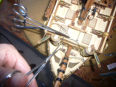

Yes--surgical gear is easy to source and surprisingly inexpensive. I also use hemostats, which are clamps for clamping arteries during surgery (ouch). They are great for holding and putting tension on lines while you are rigging. Here's a pic:
