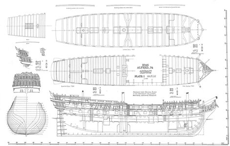

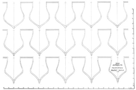

if this is your first framed hull one thing to consider is the method. Keeping the framing straight and in place is difficult. To improve your chances of building the hull it is best to consider a building jig. On the forum look at the Oliver Cromwell and the Fredrick builds these are Harold Hahn style of building. Another thing to consider is how you will built the frames either a blank and cut out the shape of the frame or build up a frame piece by piece. We have examples of both methods here on the forum.
to be honest a framed hull is way more than just cutting out frames it is more about the construction.

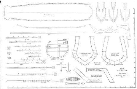

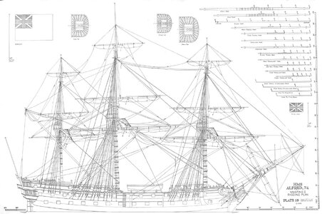

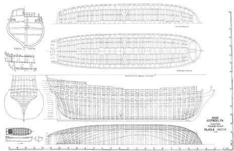

here is an example of the Alfred of 74 guns by Harold Hahn

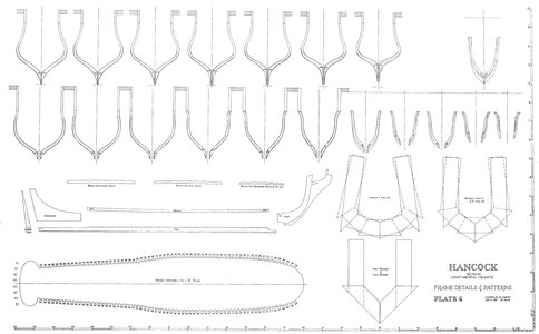

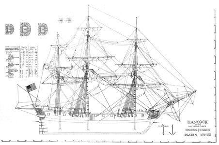

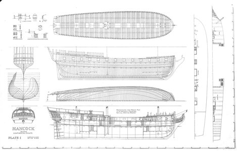

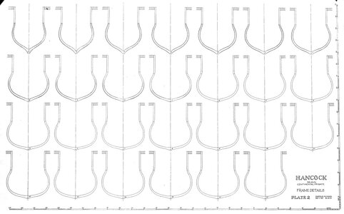

or the Hancock
the Swan build is great and very detailed but i do not think it is for any first time builder to a framed model.
As for instructions your best bet is to start a build log and have members work with you and answer questions. The problem with "instructions" are a how it is done but they do not cover problems you as a builder incounter, that is where a live build log comes in
