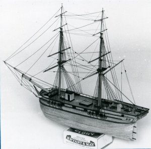

Hi Bill,
I purchase my timber planking material from ZHL models. They have Pear, Cherry and Maple in various sizes.
0.5mm wood goes under the name of veneer, and you can purchase it in sheets and cut your own planks by hand A steel ruler and scalpel is all that is needed to cut 0.5mm wood! I regularly cut 1/16th inch wood with a scalpel.
I built this plank on frame model in 1982. Tools used: Jeweller's saw, steel ruler, scalpel, coarse file, smooth file, tweezers, small vice. I no longer build plank on frame models, as I now prefer building miniatures only a few inches long! This model is the well-known Scottish Maid, I got the plans from a book, and it is scratchbuilt!

When I built my Scottish Maid (above) I just used sandpaper for smoothing the sawn wood! It was planked in 1/16th inch obeche sheet, the planks being cut with a scalpel and steel ruler.

The obeche sheet that I use is obtained from Ebay in planks already finely cut to 1/16th of an inch. I get veneer from the same place. This one is much smaller, and is planked with sycamore veneer. I built it in about 1984. I really have no interest in Napoleonic or similar naval ships, cannons and loads of fancy decorations do not impress me at all, and life on a navy ship is pretty boring, unless you get involved in a sea battle, which I wouldn't imagine is very pleasant anyway. The life in merchant ships is much more varied and intertesting, if one cares to r read about them, also, if wars do come up, the poor old merchant navy is invariable sucked into the thick of it anyway. This is the brig Neilson. A workhorse of the sea. Not very attractive, but an experiment in miniature plank-on-frame. When I was at sea myself, I didn't use machine tools at all, apart from a hand-held 12 Volt electric drill. Now I am retired, I have a small lathe, a drill press, and a hobby band saw. They reduce the building time, and effort, but are not really necessary.
