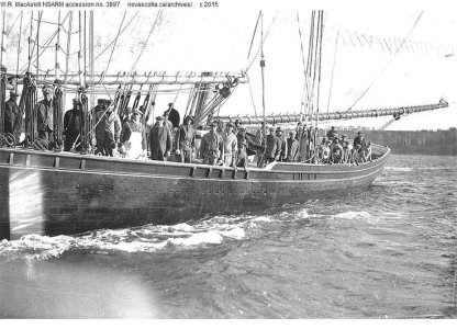

During my build of my Bluenose I have seen many pictures of W.R. MacAskill who made a lot of pictures of the old Bluenose. This is one of them with the scuppers in view:
Here they look small. During her operational life she has undergone 'quite a few modifications'.

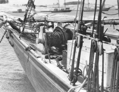

On this picture with the most forward deadeye in view you don't see no scupper anymore:

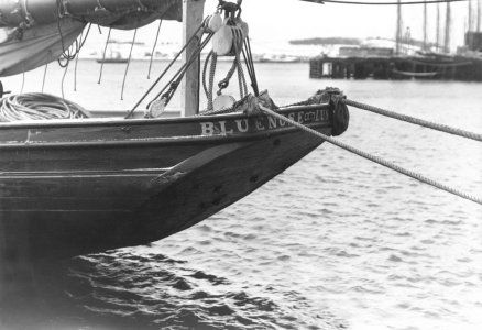

They also did no run to the aft. On this picture no scupper is in view:

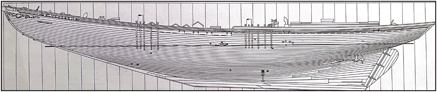

L.B. Jenson made a lot of drawings in his "Bluenose II, Saga of the Great Fishing Schooners". That Saga is based of the BN-II. But the BN-II is based on the original. He made also some drawing of the original but non of them shows the scuppers.
This is one of his drawings of the BN-II with the scuppers in view:
As far as I know the scuppers in the front runs till just before the fore mast.

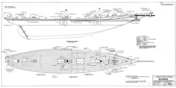

logical since the foredeck is lower than the aft deck)
I may be misunderstanding what you mean, but I think it is other way. Further to the great photos from Peter, and as was mentioned above the water runs to the lowest portions of the deck. The below shows the water line as level and the height of the deck above the water line at the bow is higher than that of the aft portion. This is approximate as I have no high resolution plans so went with this low res drawing. The deck levels difference may be a bit different than I drew in though so this could be off a bit.
Thanks Peter! The photos are what I saw too and it kinda confirms my “suspicions “. I‘ve already started building the waist line and scuppers and it’s pretty much right on. Can’t thank you enough!
Thanks Allan and Peter! The photos of the plans corroborate my thoughts. The placement of the scuppers in the plans and photos makes perfect sense: the foredeck is lower than the aft deck so naturally the scuppers are lower on the foredeck. The plans on the Model Shipways kit call for scuppers on both sides of the bulkhead stanchions from bow to stern which would ring them all the way to the bow. I am instead placing them from amidships to about the foremast area or just beyond. You guys are right: if you strive for accuracy you have to do your homework and do research on your ship, not totally adhering to a kit’s plans. Thanks for the photos and plans and your input, they really helped.
