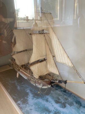

After my first model (Terror, a plank on bulkhead kit) which was finished, fully rigged and in full sail it looked pretty good and still gives me a buzz today when I give it a detailed look over in my office.

Here it comes ……….. has anyone made a single model fully rigged and at sea in one elevation and a dry dock cut away on the opposite side? Assuming this is not too wacky is this possible? Any additional points to consider? Any photos please to give me further ideas?
I hope this is not too off the wall!!!
