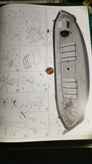

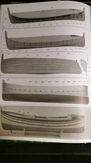

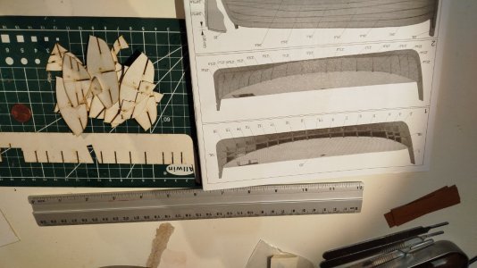

Here some pictures from the kit and the manual.
The quality of the print is really good in the detailling.

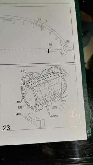

This is the drawing of one of the barrels.

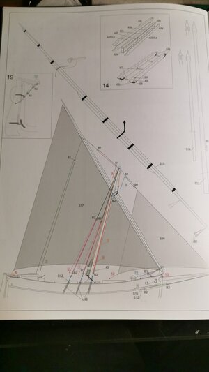

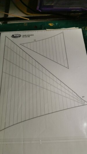

The drawing of the rig with the yard.

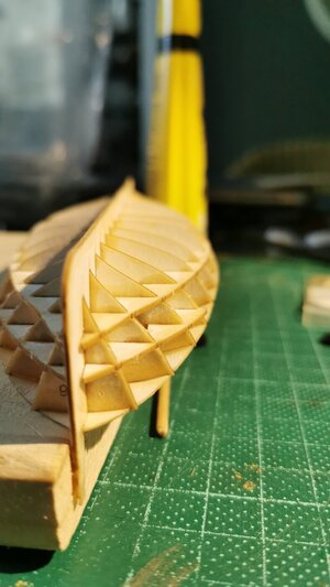

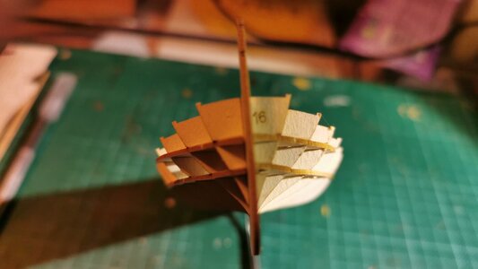

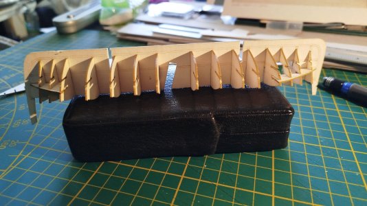

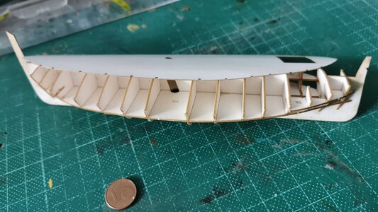

Here the completed hull skeleton.
the lines are very interesting and the deck is deeply curved. So I will work on tomorrow.

The only problem I do have got is the mast and yard. Are there any detailled informations about diameters and lengths?
Hi Chris,
...well, the model is designed as a "typical" vessel, not a specific vessel by its name, so the dimensions of the spars are approximate from sources, drawings, sketches, photos. I found a variety of spar design details and the dimensions were "matched" to this "average" leudo. The second point is that these were units of private entrepreneurs, many design details were traditionally passed down "from father to son". Some leudos have been restored, even plans for these units have been created. There is a very interesting report on the construction of leudo on the Italian forum with a huge amount of photos and details, more numerous than in my model. (I don't know if I can link to another modeling site :-)))
I think that even if I made minor errors in the dimensioning, they are the limits of the "modeling" error in the scale 1:72. I think the templates in the kit are accurate enough.
Best regards
Tomek

You can hardly belief how sloped the deck is it is really complicated to bend it
without adding accidentally an hard edge into it but the shape of the hull is very nice.

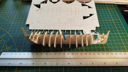

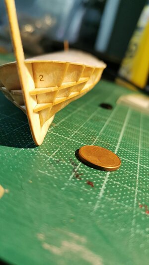

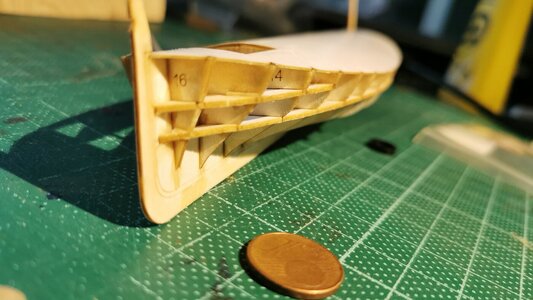

On the pictures you can see how the bulkheads and horizontal layers stand out of the line of the hull rectangular so these were hardened by the use of some liters ;) of superglue and will be beveled by fine sandpaper to bring them into shape to the hull's curveature.
The front shows a whaledeck to get coming water fastly from the deck and back into the sea and
afterview show the fine lines very well. I do think about filling the fore and after sections by balsawood the enlarge the surface to glue onto...

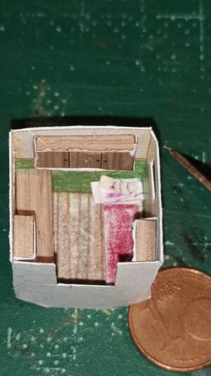

I did some first alterations die to the art of the time. Very often the walls were inntwo colours if the owner could effort it. So I did add some colour and a middle and a floor ledge. Additivly I added some wood imitation to the floor I showed this bare wood a bit contrasting to the nice wall colours.
I added some more yellow to the edges and a bit of shadow imitation under the cupboards.

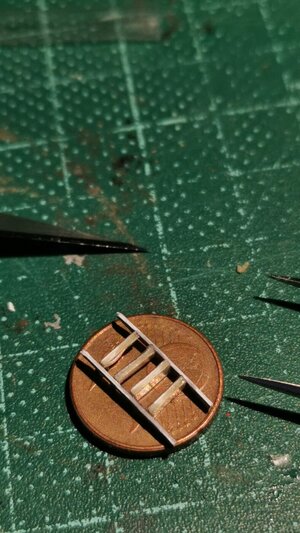

The stair is ready - not as precise as I wisched to build it but it is the very end of my eyesight...
So let's start building the furniture...
I do search for my electron microscope meanwhile.

The bulkheads do need beaveling obviously...
the horizontal parts, too

The interior is gifted constructed - with a propper staircase and stairs.
But I cut it's breadth short due to individuallicing it's appearance.
The kit has been ordered with blocks, lasercut bulkheads and extra stuff. Tomik supports me very kindfull.

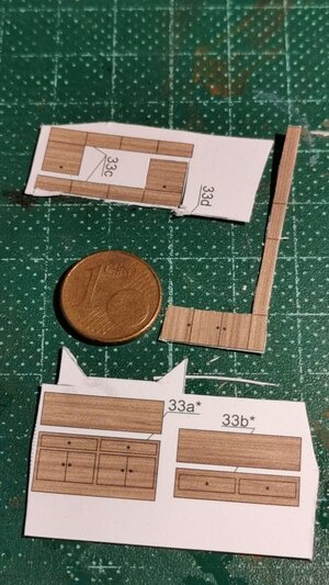

I altered the interieur to a contemporary two colour sheme with an imitated wooden bar between.

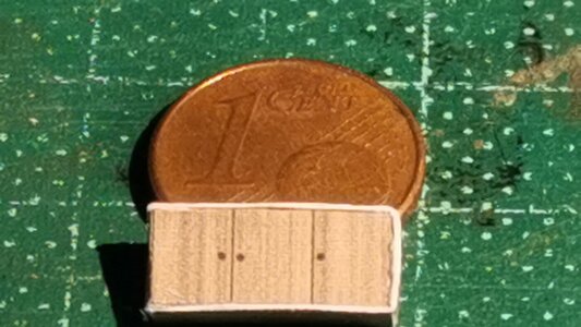

The furniture is very well done due to a lack of acrylic paint
I used my aquarell pencils to colouring the white cutting edges. I imitazed a pillow and a blanked as further detailling.
I have to sand on the interior box to get it into the notch in the hull skeleton - 1/10mm. So I hardened the paperbox by adding superglue and do sand patiently...

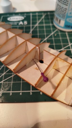

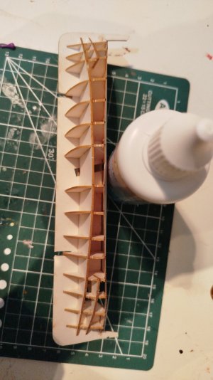

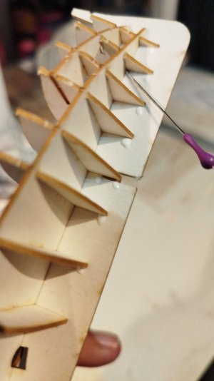

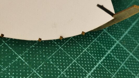

I restarted the hull skeleton using bookbinder's PVA and a needle to "press" it into the grooves
But I added two 3×1mms slots for the changed stand.
Later more.

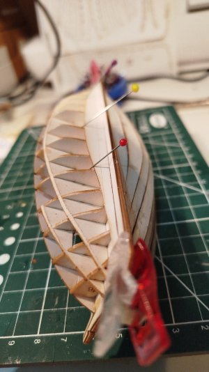

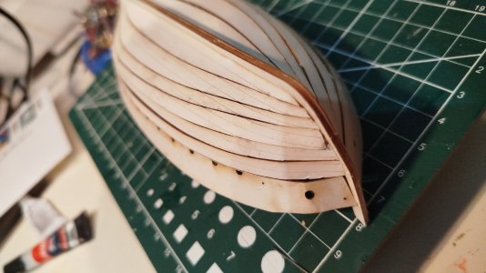

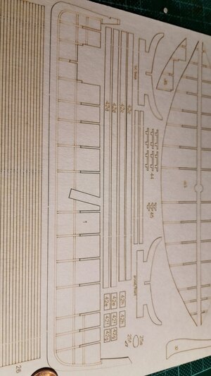

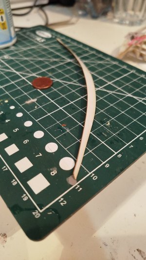

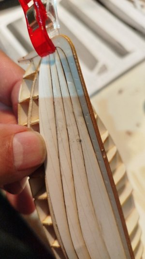

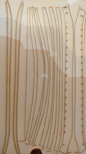

Today I tryed the LaserCut parts and the planking - it isn't being full success.
I have beveled the skeletton, brought the bookbinder's glue onto the edge of every plank
and tryed to bring them in position by using needels
- at the end I recognized my error:
I had forgotten to bent the planks longitudinal...
So I ordered a new LCset and restart when the letter is in the postbox.

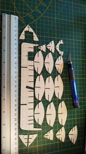

Dear friends,
my pacle by seahorse arrived on friday - but during the weekend there was noch time to open it.

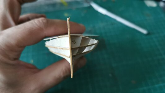

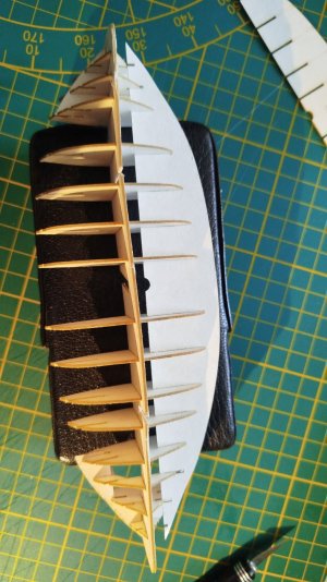

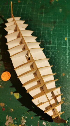

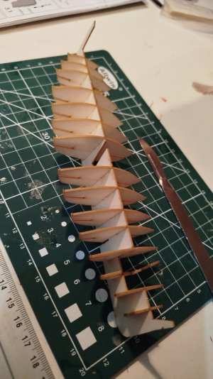

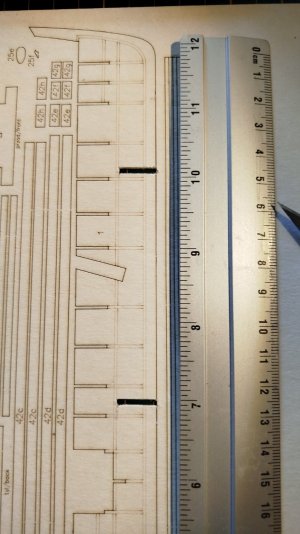

So today just a short update to the skeletton - as last time the slots for the stanchions are cut.
The rest ist as we know from.last time, the parts do go together as with a Tamiya kit.

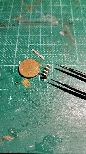

Inserting the pa4ts 18 and 19 is do by a pincette the parts are easily damage - please take care!
And yes - it is a cigar box

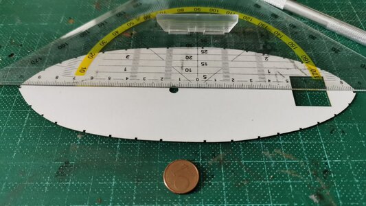

The waterline sheet is pushed in with a littel bit of shiwering the construction so the slots do find to each other.
