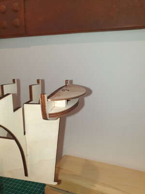

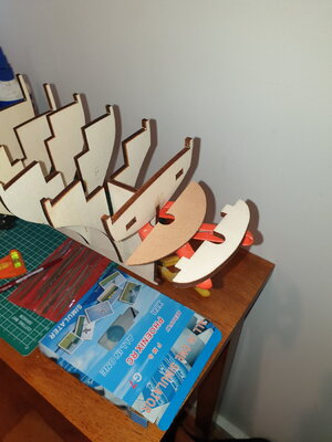

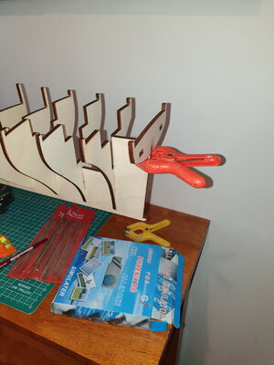

Hello,
I have just started to build a Sergal Cutty Sark and have a question re the transom setup.
The manual reads assemble the two pieces (stern brackets) to the frame. Im not sure wher20211016_120125.jpg20211016_120056.jpg20211016_112044.jpge the dark coloured piece fits? Any suggestions?

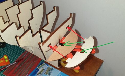

Looking at the lighter coloured but thicker playwood - here I guess this part is fitting into the two notches of the last bulkhead - see the red arrows
with green arrows marked are the two round openings for the rudder.

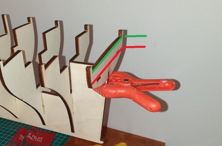

So my suggestion further is, that the thinner playwood is located higher at the deck level - it seems, that this is the false deck, which will be later the basis for the deck planking
see on the next photo marked the different levels of the two parts
