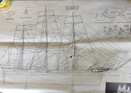

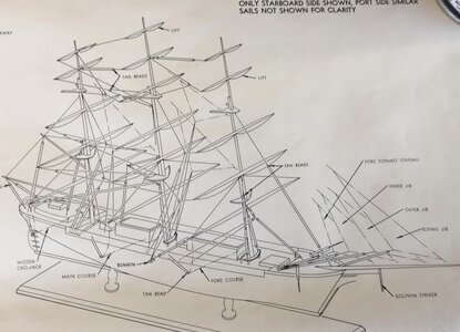

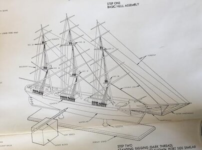

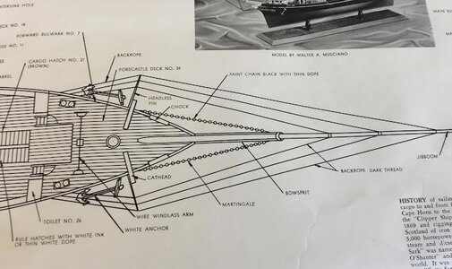

Here's a basic (and I do mean basic) rigging plan of the Cutty Sark taken from sections of the old Scientific kit's full page plan0.jpg0.jpg2.jpg3.jpg.
I know one of the pics is quite blurry. If its helpful to you I can try to get a better pic

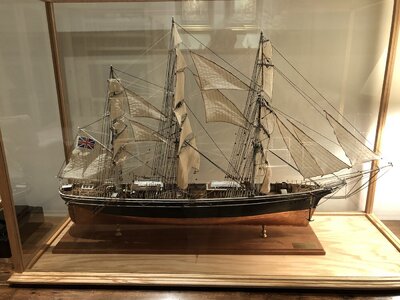

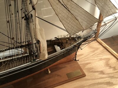

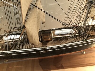

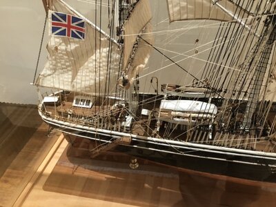

Forget the plans included in the kit. I had the earlier version and they were grossly inaccurate to the point of being laughable. I used Longridge’s book supplemented where necessary with details from Underwood “Masting and Rigging of the Clipper Ship and Ocean Carrier”. 749905E4-D397-4BD3-8BAA-37526128110D.jpegDD440054-2352-478E-A69F-343E059364BB.jpeg3A51C8EB-ED76-4C12-8457-0D9381C63E9E.jpeg72E632F3-8150-47D0-976C-164C3F84BB20.jpeg
