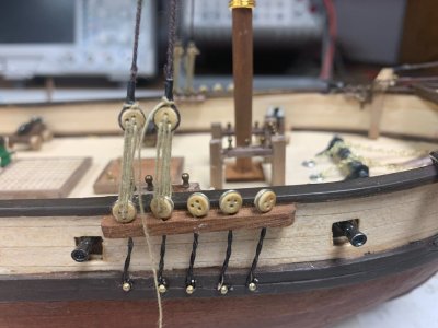

Has this idea been used and/or is it acceptable? Use shrink tubing to bring the line together. Then heat and add white glue. I used 1/16" tubing that is available from Mouser Electronics.
The line can easily be adjusted for tension before heating. I use a needle threader to pull the ends through the tubing. I've built several models and I've always had problems getting the dead eye in the right place. Bob WaltersIMG_2869.jpgace
That’s an intriguing idea. At scale it would barely be noticeable but for the shine shrink tube acquires when heated.

Do you wax the lines?
No, I don't. I tried bee's wax a couple of times and I didn't like it. Also the wax wouldn't allow the shrink tubing to crush. Also the glue I use is a thinned down (about the consistency of mapel syrup) white glue (Harbor Freight) and it wouldn't adhere to the line. That glue dries clear.
