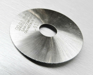

I would try one of the jewelry slotting cutoff saws (very fine kerf) in the Dremmel tool. On the picture is 2" slotting saw. They also comes 1.5' the more TPI the better. Also before cutting with any tool, I would recommend covering with masking tape to avoid 'chipping'
I would try one of the jewelry slotting cutoff saws (very fine kerf) in the Dremmel tool. On the picture is 2" slotting saw. They also come 1.5' the more TPI the better. Also before cutting with any tool, I would recommend covering with masking tape to avoid 'chipping'
Thanks guys. I will persevere on this matter.
I agree here with the hint given already by Jim - it is worth a try - but with High speed (turns/min) !!
If not, maybe show us really a photo of the problem
