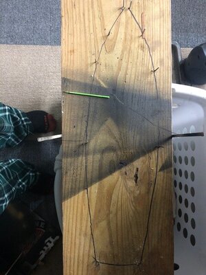

I draw an outline of the deck (hull upside down on a piece of 2 x 6 or 8 and drill holes for nails (pens) along the outline alternating sides of the outline. Place the wet wood in it and let it dry. I use scrap where the rail touches the nails so they don’t dent the rail. Works good for me. 1676136135800.jpeg
