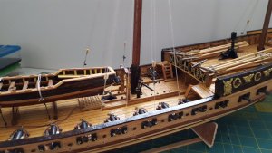

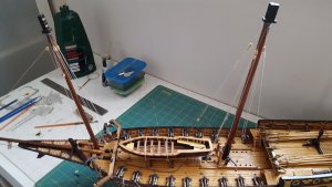

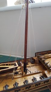

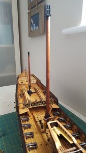

Nearly all the Belaying pints are there on the plan. On the occre plans they only show one side or opposite side numbering ( 0ne number on side, the next on the other, skipping) , so you have to replicate for the other at the same point opposite. Some of the numbering is obscured or skipped, but a close examination of the plan will show you. As all the masts are the same rigging. Once you complete the fore, the others are the same. The BIG sail blocks are a pain to cross rig but imagine a Giant Dead eye and it will work out. Th only issues I had was theading the ropes though the strips along the hull walls and tying them off so that the sail beams lined up.
