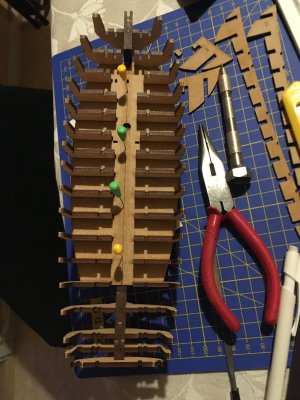

Today I have spent an hour on the construction and securely assembled the hull. Haven't glued anything yet but I think I will glue frame 2 to the lower deck part 23. I will also drill a couple of small holes in part 23 to be able to glue it to the keel and frame using construction needles. The hull otherwise feels very stable and straight without any gluing.
Pictures will come.

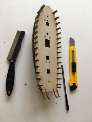

Oh well, today I discovered that the lower deck is 1 mm off in the bow.
This build has a very good fit but this particular deck probably needs to be a little smaller to be able to get it in place.
So a little warning here. I don't think I need to fix this, just remember it when I'm going to assemble the mast, for example, I may have to sand it down a bit.
Even though the kit has a good fit, it's not Lego!
Worked on, the lower deck was a bit difficult to get in place. I tried to check the fit but the description said it would snap on so I didn't dare try it without glue in case I couldn't get it off for gluing later. Had a bit of a problem in the stern and had to grab the nearest suitable saw to fix it. It turned out to be a modelrail saw. :)
Worked pretty well, a small piece of the deck broke off. But it's only the lower deck so it shouldn't matter. I think I got it down properly everywhere which should be the most important thing.
