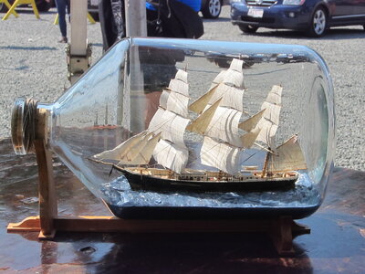

Thank you. She is the 1851 clipper Flying Cloud, 225 ft. long (69 meters) in a 5 liter lab bottle, 32' = 1" (1/384). What folks rarely ask is how long it took to build. In this case, it was 367 hours. This is one of my favorite detail pictures.
Wow,that’s amazing, Thanks for sharing. I’m putting the half pint whiskey bottle on hold because it is foggy and too small . I got a larger bottle and am experimenting with the water . Can I ask what you used for the water.it looks very realistic and the ship is beautiful thanks
Thanks. I've been at it for too long, but had a few whisky half pints along the way. The contents were so good I convinced myself the glass was clearer than it really was.
I use glazing putty mixed with artist's oils, blue cut with just a little cadmium orange so it isn't too bright a blue. After mixing, I make it into a "patty" and leave it on newspapers for a day or so to let some of the excess oil soak out. Some folks like plumber's putty, but I found the oil in it heavier, and it will eventually soak into your model's sails. It also is never supposed to harden, so the bond to the glass is not as secure. Many people like plasticine, but my few experiments did not result in good color or surface texture. Perhaps with more practice I could have done better. The late Gil Charbonneau did very good work with plasticine.

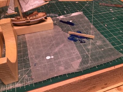

Switched to a new bottle and experimenting with the jig to hold the build. I am anxious to see how I do getting it in the bottle. The water will be just a little colored silicone just to hold it in place. Have been busy fashioning tools for the insertion.
