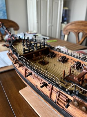

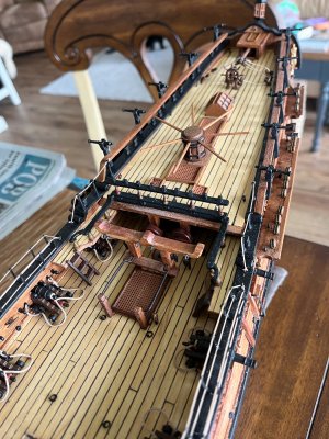

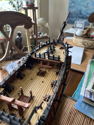

Just wondering if anybody knows what type(s) of ships boat the Swan class of ships from the 1770s carried on board. I am working on a 1/64 scratch build of the HMS Vulture based on the Victory plans for the Pegasus. The ships boat is shown carried in the waist suspended on spare topmasts and yards. A jolly at about 100 mm and would fit nicely, but I suspect that a pinance would be more appropriate, but at about 120 mm its a tight fit.

Thanks for all the input my friends. I will probably go with a cutter or pinnance with possibly a jolly nestled inside. I will post some picks of her and maybe you could let me know what you think would look best and more importantly accurate.
