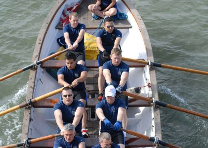

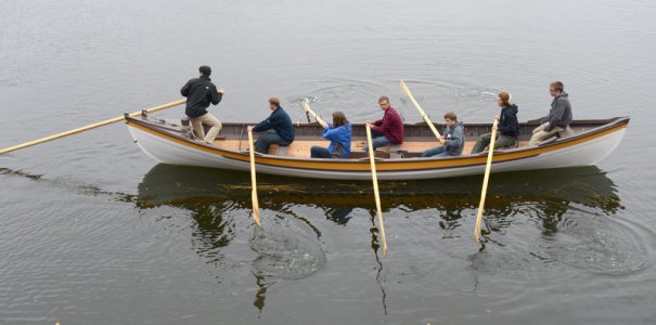

See photos below of double banked rowing and single banked. The second boat is an American-style whaleboat at Mystic Seaport. Note that the rowers are positioned on the opposite side of the boat from their respective oarlocks. The fulcrums for oars, be they provided by thole pins, oarlocks, or washboards, are typically about 1 foot aft the after edge of the thwart. This varies depending on the geometry of the set up (beam, height from floor to thwart, height from thole to rail, length of oar, etc.). Fair winds!

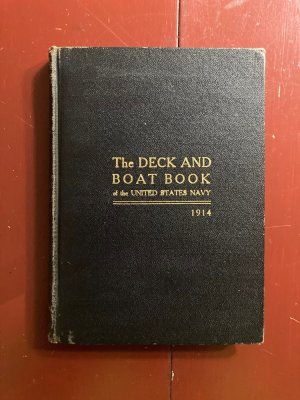

Hitchborn's book sounds very cool. A couple of copies are available on AbeBooks for $400. The book I have, The Deck and Boat Book of the United States Navy, is small (4-3/8" x 6") so that it fits in with all the gear required to be carried in boats, but has some interesting info. Where else could you find the proper naval commands and duties for a boat with a sliding gunter rig or a standing lug rig? Fair winds!

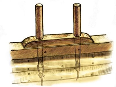

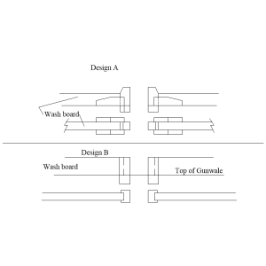

I've been thinking about this for a couple of days. Then looking at Alan's Design "B" I'm wondering if this would be just holes in the gunwales at every seating position and then they could pop the thole pins in according to how many oarsmen they wanted?
I would suggest that that’s a good possibility. Although Allen’s wash strakes with openings for oars are robust, Thole pins were fragile and easily snagged by rigging involved in launching the boat. Attaching them after the boat was in the water would have eliminated damage.
Roger
Good catch Roger. :) I do wonder about how thick they would have been. The scantlings from David Steel's Elements and Practice of Naval Archiecture show the bottom planking was between 5/8" and 1 1/8" thick for various size boats from 16 feet to 37 feet long so I am guessing the washboards would be the same or less, depending on the boat. He does give the breadth of the boards being from 4 1/2" to 7" depending on the size of the boat, but he did not include the thickness.
It's likely that the person who drafted that plan considered the arrangement of the oar fulcrums (washboards, tholes, or whatever) to be a standard feature that required no detail on the plan and/or a feature that was added by the ship's carpenter and not required to be completed in the shipyard. Tholepins would not usually be fitted into gunwales without blocks to protect the gunwales from wear (see picture below). Also note how the thole pins are tapered to fit the holes and are secured by a lanyard. The lanyard is attached to both pins and they are unshipped by pulling the pins up and letting them fall inboard. Fair winds!
