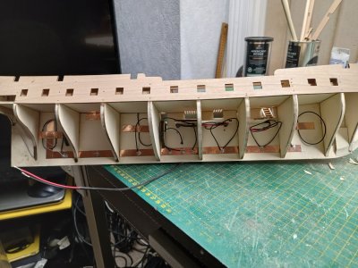

20260531_103403.jpgI use copper strips on both port and starboard sides of the keel and run the main cable through that Las Mercedes so used flickering 3mm LED's you don't need many
