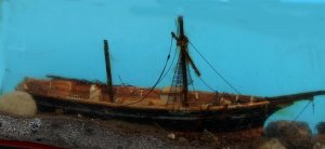

This was quite difficult to photograph. I made it over 40 years ago, and it should last forever, as it is sealed in a block of clear casting resin 100mm in length, 40mm front to back and 45mm high. Although the resin is clear, I photographed it on a sheet of blue card to give the appearance of water. The resin attacked the model and gave it a mottled, lumpy appearance -

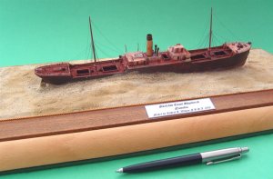

When modelling bases for tank dioramas I used to use ready mixed grouting - what you use for bathroom tiling etc. It has a fine granular appearance when dry and takes paint well; I used several differing shades and airbrushing or colour washing both work fine.
