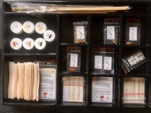

Opening the box, I was impressed with the components. I’m a 18th century historian, and familiar with what period warships look like. As a novice modeler, it’s crucial to me to have most of the ship precut, and just assemble parts with minimal shaping. This kit seems to provide that. It’s organized well, in a tray with everything labeled, numbered, and tagged.
19902496-ED43-46BA-B065-1813B5DCF239.jpegC68BB365-AEF0-4535-AE07-A089F228D817.jpeg683BF0DB-0315-48BE-82D9-68D4CD357F35.jpegAs a former artilleryman, I was obviously drawn to the gun tubes, and they look awesome. They’re even bored out, separate trunnions and well cast.
Under the tray, we’ve got the card sheets, and they look good to me. I’m going to be glad I don’t have to do any planking by myself here. The deck looks good, with the planking laid out, and I’m already thinking about improving it when the time comes to paint it. Again, since I’m somewhat familiar with how a real ship was built, I can visualize what parts are what.

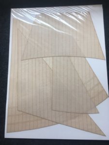

Included is a suit of sails, and they look good, although my model will not have them set. I’m planning to display my Revenge alongside a wharf, as if she’s fitting out, so my sails will be folded onshore, waiting to be put aboard.

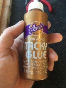

I use 'Aleene's Tacky Glue' for anything paper or card - I searched the internet for "the best glue for paper crafts" and it seemed the most recommended. It works for me - gives enough hold while you get a clamp.

It’s been a few years since I built this, but I believe I used ordinary Elmers glue. It’s tacky when you apply it and you can readjust parts or even pull a plank off if the glue hasn’t set. i applied and spread it with a toothpick. You can still get it at your drugstore. There hasn’t been a run on it.
We’ll designed kit, but doesn’t have the same tolerance for mistakes as a wooden model. You also can’t clamp anything. You have to use finger pressure until the glue sets.

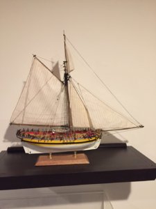

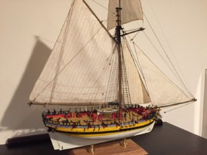

what is your Revenge? Is it a kit?

Thanks guys. My carpenter friend also said simply use a glue like Elmers or craft glue, which I certainly have at the house. So that’s what I’ll use. I removed the main hull components from the card and test fit them. Looks like it should, and it fit together perfectly. I’ll glue it up tomorrow and set it in the cradle to dry.
SMB, it’s a stock Alert kit, I’m going to basically modify it by leaving off all of Alert’s fancy work, put a beat up and weathered paint job on it, add two more 6 pounders and more swivels (the documentary evidence says she had 14 sixes and 20 swivels) and make a Continental Navy ensign and jack to fly on her.

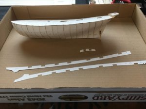

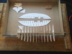

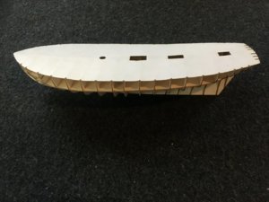

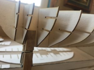

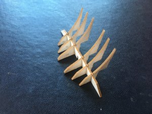

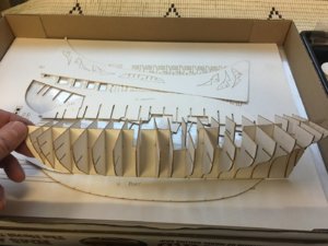

Today’s progress. Got 14 bulkheads installed, and did the stern framing. I’ll let it dry and get bulkheads 15 to 18 in place tomorrow since those go in from the bottom. So far, it’s going well. The Tacky Glue Sulaire recommended works just fine. Everything is lining up with the laser cut guide marks well. We’re going to see how much fiddling has to take place when I install the lower deck halves.

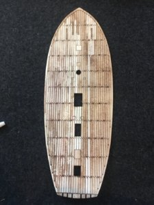

8B6A4259-5184-4D98-A3A9-589EE4A3335B.jpeg2CE7C16C-B1C0-4737-87C9-937B22531D39.jpeg3510DA77-67ED-4F13-9883-BCEAF10EA3F6.jpegWhile the hull dries, I’m thinking about hitting the upper deck and the visible lower decks with paint. Remember, my goal is a weathered look. I’m doing a little research on real deck colors, and at least on some extant ships, (Victory and Constitution) the upper deck has weathered to a gray color. The question is, is that color actually period correct? Since the decks aren’t being holystoned on a regular basis as they were when they were manned as functional warships, is that color incorrect? The Marryat watercolors show the decks as a grayish brown, but I’m not going to take it as gospel until I hear some other opinions.

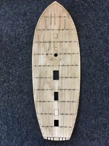

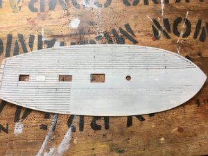

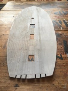

I laid the first coat of weathered deck.
Instead of paint, I used some walnut dye I made last year from black walnut hulls for 18th century material culture projects. Wiped it on and quickly off. There’s little bits of sediment in the dye that add darker spots and imperfections that really seem to make this technique have promising results. The deck isn’t a uniform color. An added bonus was it made the ink on the planking and treenail print begin to bleed into the planks just ever so slightly, so it looks more like a working deck, rather than a printed card. I’m going to add one more light coat tomorrow and see if that’s what I want. 0FEF6315-3008-4721-BF09-14A0964AF6A9.jpeg

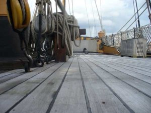

You are absolutely correct. The appearance of the decks was and is more grey than brown
On modern sailing ships the timber is oiled, but in the past not....

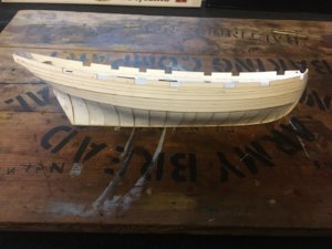

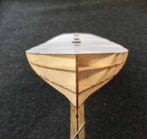

Today’s progress. Yesterday was too nice to be inside so I was out in the woods scouting for turkeys.
I got the bulkheads on above deck, and started the wales and strakes. Not too bad right now, but this is the easy part.477840C1-861B-41ED-BEB7-A51FD50A1549.jpeg936CE081-E2BB-4A14-AE10-54DA19AE35BD.jpeg

What happens with your deck? I think your technik has not worked as expected?
No, it’s just laid aside as I get into the hull build. I want to get the inner bulwarks painted and the other stuff in before I lay down the deck.
