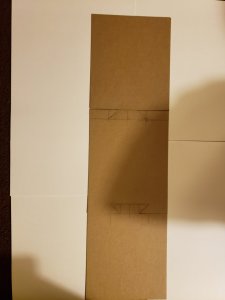

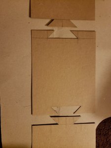

While I was waiting on other Projects to dry I decided to start on this Build. I had a hard time finding 1mm thick non corrugated cardboard or paper to make the frame from. then when I did find something close enough its in small sheets. So I notched 3 sheets together 20181013_214945.jpg
Glued up with Thin CA to make one sheet

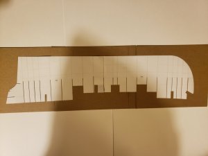

I cut out the pattern for both sides of the cardboard sandwich and glued it down to one side only when this dries I'll cut it out and glue on the other side

Hi Joe, that's quite the undertaking! I've looked at the Shipyard Victory and ran the other way:) A good source for 1mm cardboard is what they call greyboard at most art supply stores. Another is magazine stores believe it or not. It's what they divide up the hordes of magazines with when they are shipped. Comic book stores usually have it by the ton every month and they use it as dividers in their bins but mostly recycle it. The backing board for comics is also another source. From experience, I'd say try to grab onto 1mm stuff as a little bit off here and there will definitely add up to a big error with Victory in the end. It really sucks cutting out all those formers just to have them disappoint you later. There are a ton of Polish hobby sites that sell laser cut
former sets for pretty cheap. The polish companies use a very dense beer coaster like material. I'm gonna watch this one!

Thank you for the info Brother none of the craft stores had any that was 1MM, closes I found was .5mm. I went to 4 different chain stores here in the US I went to Office Depot nothing to be found. Walmart nothing. I checked the Net for it, but most places didn't have it or wanted me to buy a ton of it and that wasn't gonna happen, I'd just as soon roll the kit into a log and Heat the house with it in the fireplace lol For exactly 1mm thick the best I found was Slip Sheets Used for the Folk lift Industry. I work in that Industry and had customers who used to use those, but no longer do. A slip sheet is thick dense cardboard non corrugated its used as apposed to a pallet. a few places I used to service moved to the plastic ones as they were reusable, Slip sheets are exactly 1mm thick, but Id have to buy 5000 min. The stuff I found and am using is 1.05MM thick so no big deal as its used for the frame and bulkheads Heavy structural stuff that I have seen so far in the kit.
Usually I'm pretty demanding about using exactly what I'm supposed to, but in this case I was no longer willing to be stubborn since its not that far off. I do have exact .5 mm and I could double that up but I'm not into making more work for myself when I have something close enough. My wife isn't happy about the build as I have amassed a rather large supply of paper in all thicknesses rolls of non corrugated cardboard card stock chip board and anything else I could find in my travels to build this kit with. All of it donated by my customers to see if it was thick enough. it would have been better to just take my thickness gauge to work with me, but for some reason my brain wasn't working so as I saw what might work I asked for some of it. I have enough to build 10 ships no doubt about it. lol Its all good what I don't use for the ship I can use as fire starter for the fireplace. The board I found wasn't cheap was like $18 for 20 pieces 8.5X11" But I got tired of searching for the right stuff so I gave in and bought it. BTW do you have any links to the laser cut stuff

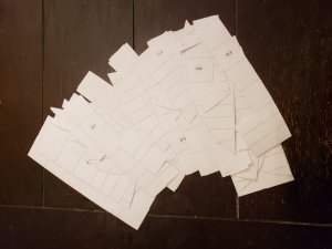

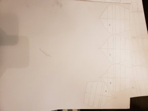

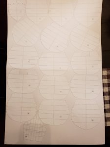

Got a bunch cut out thanks to my wife for doing that chore for me this is all frame parts. Started gluing the bulkheads to the 1mm board. She even left me the line so I can trim it to what I need she's a good woman.20181025_100021.jpg
I'll do all the notching with a razor knife. If anyone else is building in paper or has built in paper what glue are you using? I'm using PVA and I'll stiffen all the edges with CA.The PVA works well, but it's a pain to apply without the paper trying to curl itself into a tube I have to clean my hands after every single piece I glue or it will leave little boogers. Yes I'm spreading the glue with a finger.

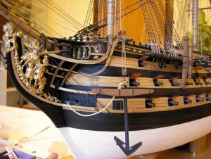

I have been looking at paper models and They are simply amazing. Are they difficult to master? Are they built as ALL paper? It seems that wood parts have been included into some of the builds I've seen.
I was a paper guy for years and had a lot of fun building them. There are purists who say that mixing media, adding wood, plastic etc is blasphemous but I say do as you will and have fun. Paper uses a different skillset and isn't very forgiving but if you make a mistake, you can always print another part and they are much easier on the pocket :) There is a lady out there that builds card ships you would swear were wood. Doris is her name and her stuff is brillant. She was my inspiration to take on Bellona. Here is her Victory as an example that I grabbed after doing a Google search
Doris uses everything from cardboard to Mac-Tac to Sculpey Polymer clays for her decorations etc. Card models are a bit easier to manage in a apartment with all that is needed is a printer/scanner, self healing cutting mat, some different glues (PVA, CA, possibly spray adhesive), straight edge, hobby knives and perhaps paint or colored pencils. As you get going you'll definitely find more tools that can be adapted. I warn you...it's addictive!
