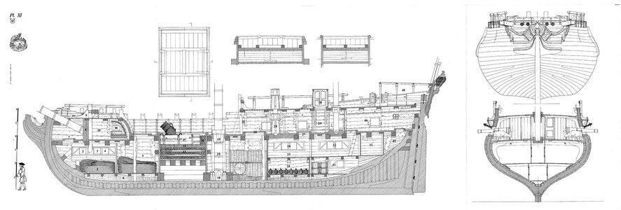

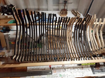

Shipyard on the table. The La salamandre 1752 a longitudinal section of a ship
