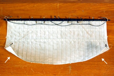

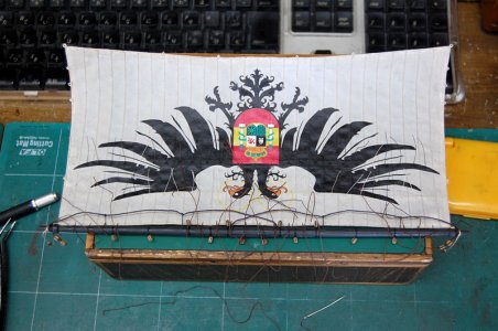

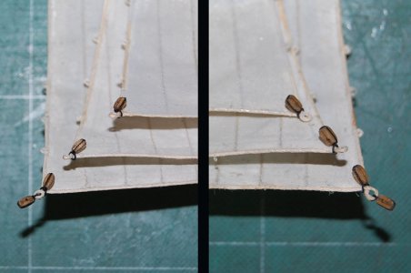

This image shows the Reef points attached to each sail, with the sail being attached to the main lower yard.

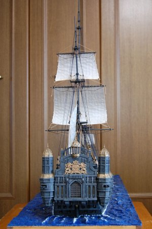

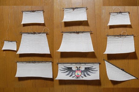

Sails have been attached to all yards.
This was meticulous work, so it took time.

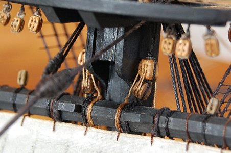

Starting tomorrow, we will prepare to attach the yards to each mast. This preparation is also detailed work, so it will likely take time.

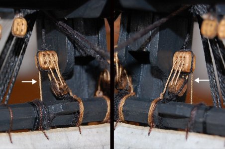

Attach pulleys to each end of the sails.
This is another fiddly and tedious job, but these pulleys are essential for the running rigging.
Let's just buckle down and get them attached!!

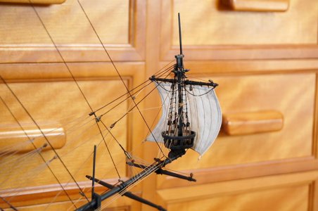

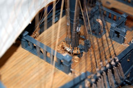

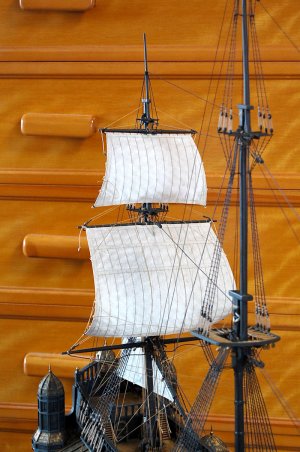

I installed the split topsail and yard set.
The rigging is incredibly complicated to handle.

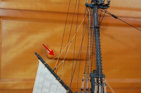

The split top-sail and yard rigging terminate at the red arrow point.

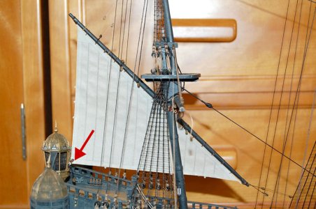

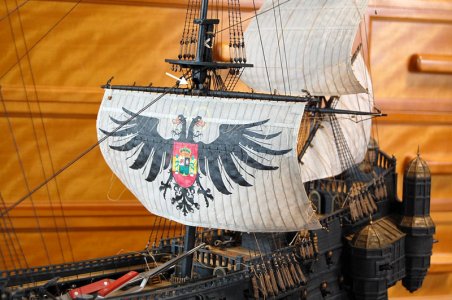

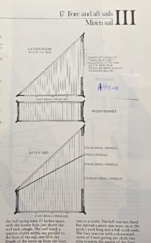

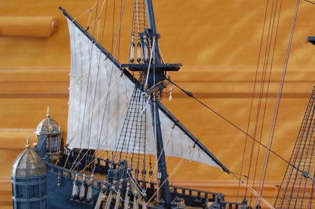

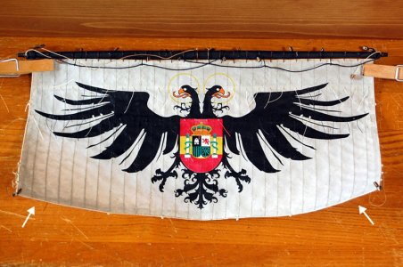

I also installed the lateen sail.

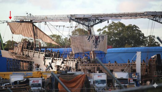

I made the rigging here the same as the Black Pearl (since the Silent Mary's rigging in this area wasn't clearly shown in the movie...).
The red arrow section hasn't been processed yet, but this will also be made into the same rigging as the Black Pearl.

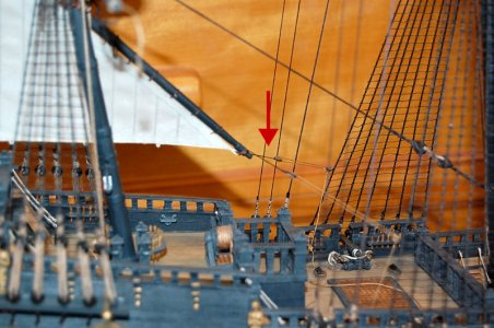

The rigging arrangement at the red arrow section is the same as that of the Black Pearl.
The rigging arrangement at the red arrow section here is the same as on the Black Pearl.
