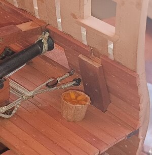

I am hoping to simulate some water barrels, with a ladle for crew drinking water.
Here is a first attempt. A barrel cut in half and filled with wood glue.
ANY IDEAS on how to make the glue look like water? Blue paint? Some kind of Acrylic fill?
Thanks in advance for any and all advice and suggestions!!
Clear casting resin would be my choice but try them all to see what you think looks best. Put the ladle in the bucket and pour in the resin and it should be clear enough to see the ladle after it has cured.

epoxy works great. you can also tint the epoxy blue so you have some contrast.
Thanks everyone, I LOVE the knowledge and advice on this forum! I will be ordering some casting resin, acrylic water, and epoxy to see what gives the best effect in the small buckets.

I have used “ woodland’s realistic water “ to simulate water. Model railroading folks use it.
Check their website, it’s great. You could add a water base paint as well to get your desired effect
Maybe, considering waves and the motion of the ship the bucket should be only half full?
I have done the water thing in buckets for Gauge 1 (about 1/32) railway models. I simply used clear acrylic varnish on top of epoxy resin. A layer about 3 mm (1/8 in) thick dries with a wrinkled surface that looks a lot like rippled water.
Hoy, I use the clear glue for canopies on Aircraft models. It's a dull milky color as a liquid but dries to a glossy clear. Then paint the bucket and where any glue touched the rim of the bucket. It works fine for me, your local hobby shop should have some.
