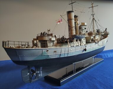

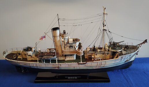

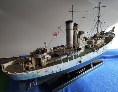

Sir Kay Round Table class Minesweeping Trawler 1942/45 Scale 1:48 .

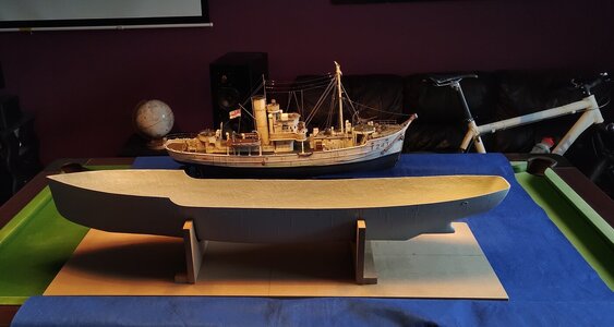

Meant to do this a while back but wasn't thinking. I want to thank you all who took the time to look this log and show your appreciation by adding a like etc. and particularly those who added a comment or two, it's your encouragement that keeps me going. I wasn't joking when I said I have not found a place to show off Sir Kay, and in fact it is still sitting on top of the pool table where the above pics. where taken, and I am getting a lot of ear ache about it.
Now for the hypocrisy! To my surprise I ended up enjoying this build, so I have went and got a Fleetscale hull of a short forecastle flower class corvette in 1/48 scale. And first impression is just how much better the hull is finished compared to how the hull of Sir Kay was. Nice people to deal with too and highly recommended. What I will do with this big girl when I get her built I don't know. In the garden and crewed by Gnomes if 'she who must be obeyed' has her way! On first seeing this hull 'She' came out with another Chief Brody misquote ' Your going to need a bigger house!'
Won't be starting for a while until I do a bit more research and perhaps build Revell's Snowberry to get a feel for the ship type. I got the Revell kit a few years ago as a present and have never as yet opened the box.

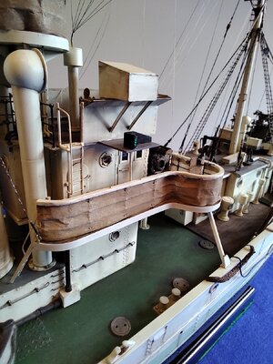

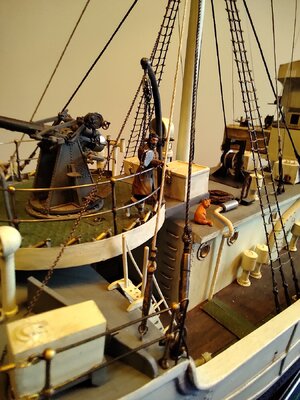

Jack, where did you obtain details regarding the column of the gun platform and the opening under the deck? I know there should be an opening, but can't find proper information. Your column is logically "coning" upward, but there's still really not a lot of space to get into that opening. It is a weird space anyway (in reality, not your model).
Hi Marco, do you have copies of the 1/96 scale Lambert plans? If so, if you look at the cross sections (59) it shows the column,it does look conical in my build but this is just an optical illusion. the perforated flanges adding to the effect. As for the space, there is in reality enough space for the crew to pass either side. I must admit it does not look pleasing to the eye, almost a desing afterthough. BTW if you need the set of the plans personal message me an address and I will post mine over (bit scruffy!)
Cheers JJ..
I do have the Lambert plans! Thanks anyway. And with your thoughts I’ll have another good look at that area. Worst case, I’ll wing it and just take it from your photo.
About that column and the flanges: indeed. Now I understand. And it’s rather logical.
Thanks ! Great help.
