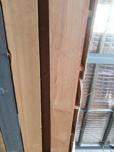

Hi all,
Does anyone have any experience with the use of Sitka Spruce for ship modelling?
I have the opportunity to buy the attached pieces but according to the Janka Hardness Scale it appears to be only slightly harder than Pine and possibly too soft for ship modelling: https://www.wood-database.com/sitka-spruce/
I have not been able to see the pieces in person as they are interstate.
As you say, very soft wood, I have materials of this type myself, but I will not use it for anything other than a first layer of planking and filling blocks aso, greetings-
I think probably there are better choices. Spruce is a common wood used heavily in construction. It's strong and relatively stiff for its mass. It's a little "fuzzy" when worked but...?? Also tends to have larger, more prominent sap veins.

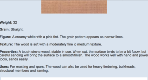

Here you go: According to Dave at "The Lumberyard"...

I've often wondered if the hardness of wood is that important, once the model is built is there that much wear and tear involved?
I know they use it a lot in guitar, ukuleles etc for soundboards.
Mellpapa used Balsawood for his models. I know a lot of builders use Basswood, Cedar and Spruce so i do not think hardness is a big issue.
I think the real issue here is suitability of purpose. Sure, you COULD use pine or fir or spruce for a model. BUT for the same reason we don’t cut 2x4s to frame houses out of French Walnut or Quilted Maple, and we don’t make rifle stocks out of pine 2x6s, and we use Osage Orange for bows instead of Desert Ironwood. ... Suitability of purpose.
For modeling... there are far better options than resinous construction grade lumber.
I know, sometimes you have to make do. But this isn’t an emergency. If you’re being intentional about buying wood for modeling, why would you CHOOSE spruce.??
