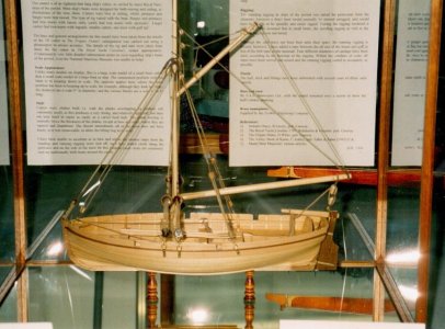

Hello everyone. I am need of some help. I need to get my hands on this craft. This is the skiff from the Endeavour. It would be around 150mm in length. I have checked the usual suspects, but no dice. IMG_0342.jpeg

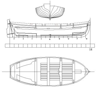

Do you know if the drawing you posted is based on historic information of her skiffs? John Gathrey and Joseph Banks. both had private skiffs on board in addition to her other three boats. I would be surprised if there is any detailed information on what either one of them looked like, sizes, etc. Hope someone finds details. There are several contemporary plans of skiffs on the RMG Collections website but they are late 19th century when keels were seen on some the contemporary drawings. Still might be useful. They have others but not available on-line so a guess as to how appropriate they would be. From what I could research skiffs generally, not always, featured a flat bottom with no keel and a squared-off transom unlike the drawing you have. Like most things in our hobby, there are very few absolutes. Cutters were predominantly lapstrake built, not carvel built which does seem to match up with the drawing you have. If you know the lengths of the two skiffs, a yawl or cutter drawing might work if you modify the drawing to have more of a flat bottom, reduce the breadth and leave off the keel. There are about 2000 contemporary English cutter plans on the RMG website.
