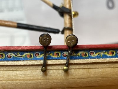

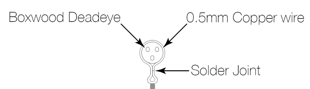

Is there any personal experience with soldering copper wire close to a deadeye for a chainplate build? More specifically I plan to make my own scratch built chainplate for my current build (HMS Surprise) that is more correct than the Artesania provided parts and plan detail. I have the following concerns:
• Will soldering this close to a deadeye cause significant burning (or discolouration) of the deadeye itself? (photo attached below)
• I plan to have the soldering joint hidden behind the 3mm thick walnut chainwale support plate as the solder will not be affected by the blackening process
• If I immerse the finished unit in blackening fluid, will the boxwood deadeye be stained by the fluid? I intend to stain the deadeye AFTER blackening the copper wire.

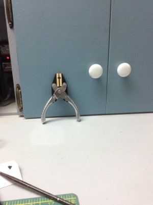

deadeye/ chainplate crimper- temporary wooden jaws glued to parallel jaw pliers.
This is a GREAT idea Roger!!!

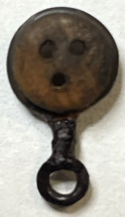

So I managed to make a bunch of these (52) successfully. Initially I used the wire that was included with the kit. It was 0.5mm diameter, but it did not look correct with the deadeye, as it was too small and was almost completely hidden in the deadeye grove. So I tried some other wire that I had and 0.8mm looked right. Had to wait to get a roll of sufficient length to do them all.
The procedure I used was to shape the wire around the deadeye (round pliers marked with deadeye centre diameter), fashion the chainplate attachment loop, then solder the area that would be hidden by the plate. After that I blackened the wire - and the blackening agent doesn't affect the deadeye wood. Yay! Minor issue with trying to polish the blackened copper after this, but not a significant problem.
The soldered area was "touched-up" with a black marker pen:
