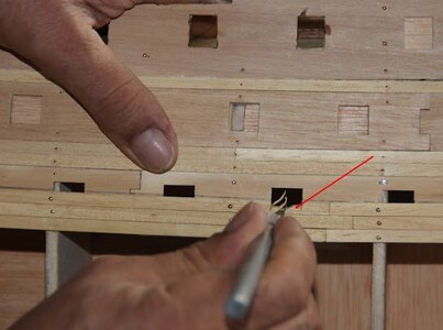

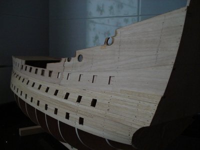

This 1Th. part is/was to show, what tuu gets from weekly delivery from Altaya. not one single 1:1 drawing of hull etc.

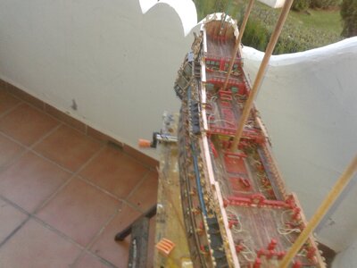

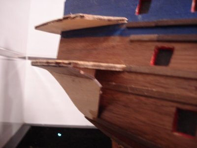

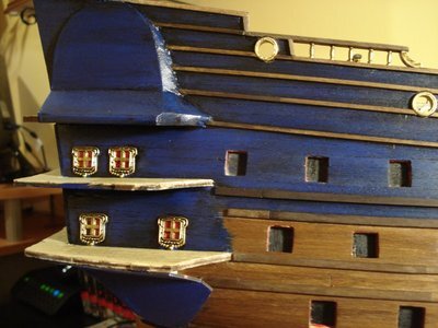

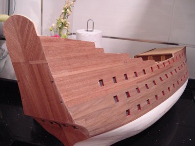

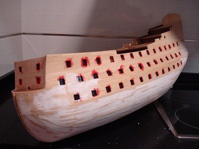

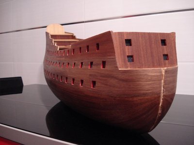

planking the bow was a must. after the first coat was, a 2 Nd planking was added with contact glue after filing small failers and fillers were added. The next big problems were the side gallery. I finally added fillers into the empty space. as can be seen, all gunport were fake. a piece of wood glued behind and a dummy gun inserted, resulting in some going loose and into the hull. no wat- apart from open the lower part of the hull-to get them out again. the 2Nd picture shows the mother nature sanding. I am only less than a mile from the seafront. high humidity, in sommer high humidity and heeat. the change in the wind, sometimes coming from the Sahara desert with a lot of sand- nature's own blast blasting.
The next shot will be about the riggen, mat and sails

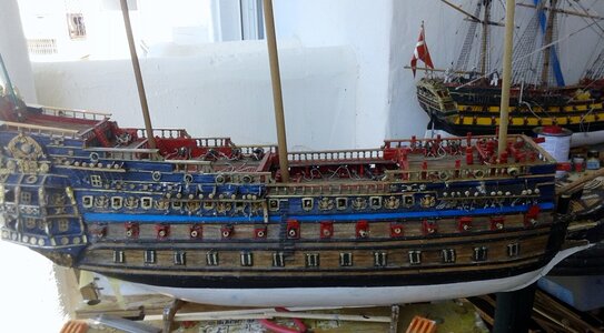

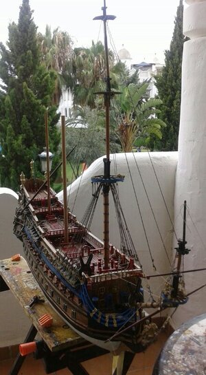

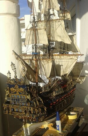

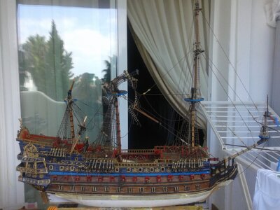

pre-painted. the gun port can be open or closed.
hull and deck are mothers natures weathering living near the seafront, and the model standing -wind, sand, humidity and rain - out on the terrazzo, -when no space inside- the ship in the background is Norske love 2, being refitted, after 5 years in a Beach restaurant
hull and deck are mothers natures weathering living near the seafront, and the model standing -wind, sand, humidity and rain - out on the terrazzo, -when no space inside- the ship in the background is Norske love 2, being refitted, after 5 years in a Beach restaurnt

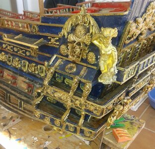

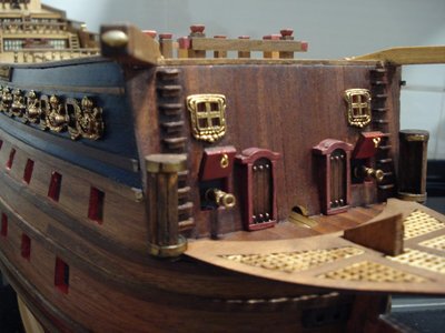

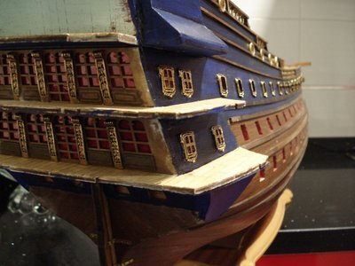

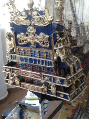

A few more pics of the build. The side Galleries were very dificult to build. at the end a add fillers, before the cloosind plant at the edge.

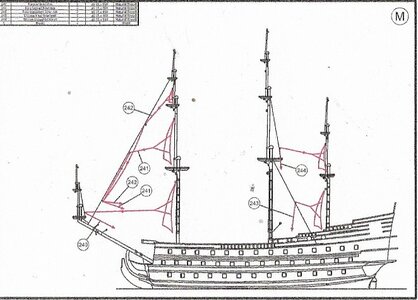

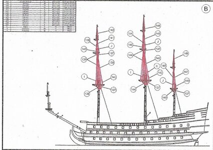

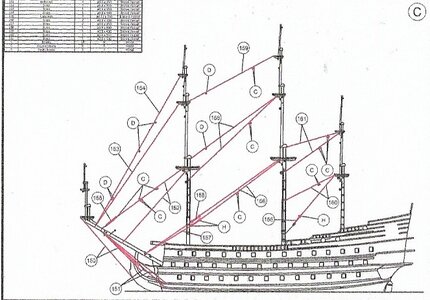

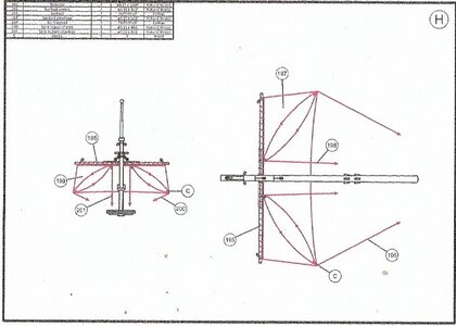

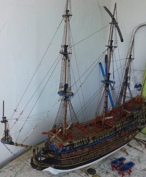

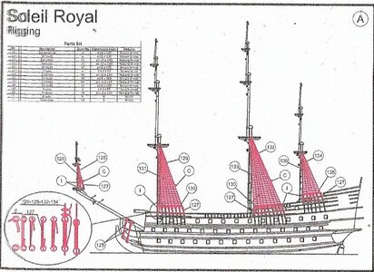

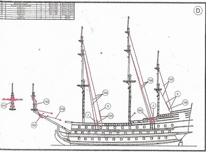

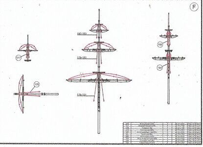

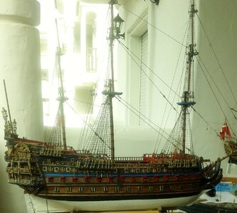

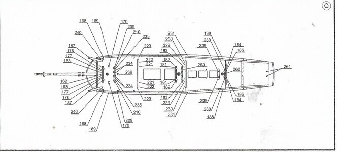

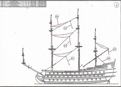

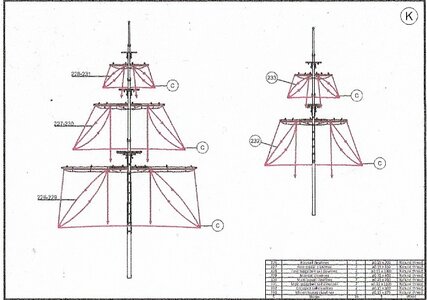

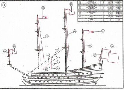

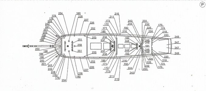

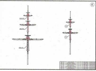

now the riggen starts. a general view and the bowsprit, fore, main and mizzen mast (in PDF format can be open with Acrobat Reader) they are all in 1:1 format. the original went to France.

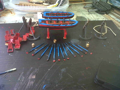

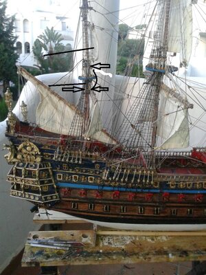

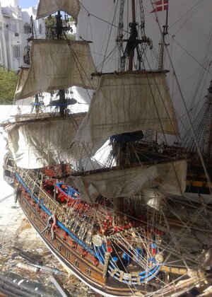

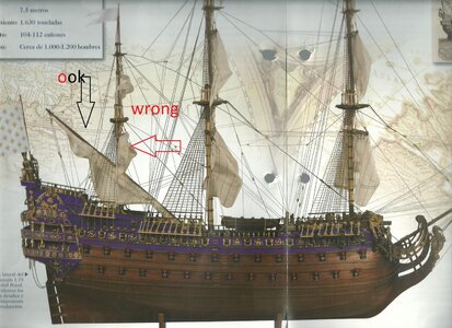

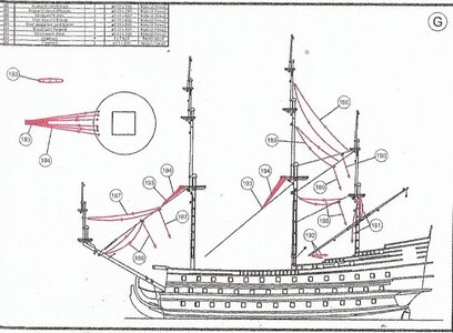

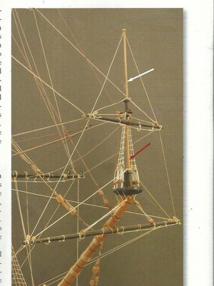

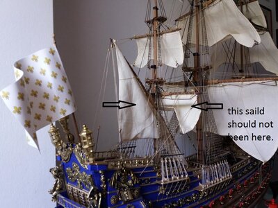

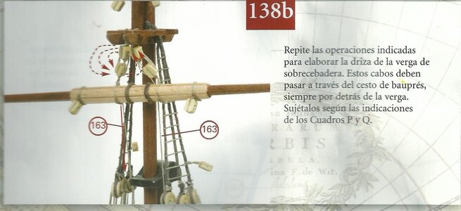

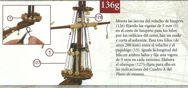

A few words about my Riggen -being without drawings or plans- so failure occurs. According to instruction, there was/is a big mistake on the upper sail on the Foremast. It was far too little compared with the same sail on the mainmast, but I went on- Wrong. The main mast was correct, but the failure in the instruction manuals come when I came to the mizzen mast. The mizzen mast -according to instruction -was Rigged as the mainmast with all tree square sails, as on the fore and the mainmast - WRONG_- There should be No sail on the Lower Yard, as later the Spanger had to be added. When I found out about the mistake I was so angry, that I went on - I did not care anymore about this ship. 6 months later -after standing outside on the terrace, I dismantled totally. Destroyed the hull etc. I still have all the Fig. and gunports and other metal parts. On some of the pic, I have made some arrows to show where the mistake were. next bach I about the riggen plan -which all came att the end- after nearly 4 years build, and believe there are some interest to see them
