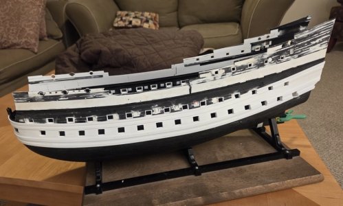

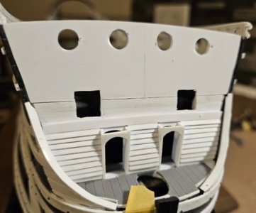

Small update. They’re all small these days, but chipping away.

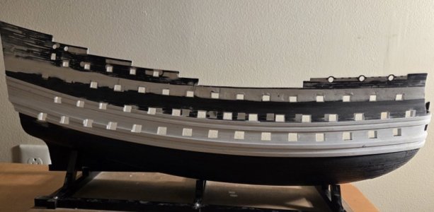

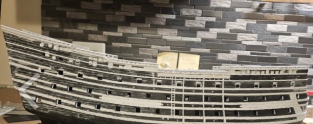

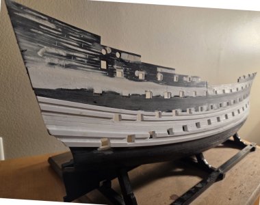

I will say that it is always remarkable to me that no matter how scrupulously I draw something, and use straight edges to scribe the lines into plastic, while also accounting for the half-width of the blade-to-point (and the half-width of the drawn line) - there are always WILD discrepancies from the drawings, in the cut parts.
It is essential, IMO, to make the actual parts fit the initial drawing, because the pattern/drawing is based directly on the actual deck camber; minuscule discrepancies in angle-to-post will create gaps between panel and rail that are much more difficult to remedy, given my sub-assembly approach to building these breast rails.
Here are my panels laid as carefully over the drawing as I can, after they’ve been parted on the lines with a razor-sharp chisel:
One has to account for the shortcomings of phone-photography - which does not provide a truly flattened perspective in close range, however, it is evident in the picture above that there are overlaps, and angle-to-post inconsistencies that would make a final glue-up far less than ideal.
My advice to anyone that reads this will be to trust the quality of the initial pattern that you make. Base all of your geometry on that. Shape your parts as closely as you can. You will have FEWER surprises on assembly.
Part of what is happening here is that I am paring to a line with a really sharp chisel through soft plastic that is less than 1/16” thick. I am squaring that chisel intuitively by eye. I am careful to always leave less than 1/32” for my final paring cut to the line. And. And, yet. The chisel will still drift to an out-of-square cut.
I say all of this to say, that fitting these small panels to a drawing:
is a process of consolidation; of checking and re-checking against the drawing; a little from the lower left corner; a little from the top right. Oh, and the central panel does require some actual camber along the top and bottom surfaces. A very little here, and a very little there, and eventually I have arrived at a reasonable bet for sub-assembly:
I will note that the central “Soleil Royal” badge is, in actuality, 1/64” off center. I point it out only to highlight that this is what the eye can perceive. In this instance, it is a consequence of process and bonding.

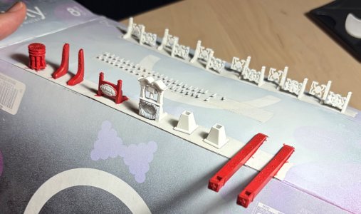

I’m using C/A to bond BONDO to plastic. The window for placement is limited. I managed to get the top/bottom spacing right. In the end, after all is said and painted, and posts are in-place - the discrepancy will hardly be noticeable. There is too much else for the eye to focus on for it to matter.
Next, I will make the knee/post supports.

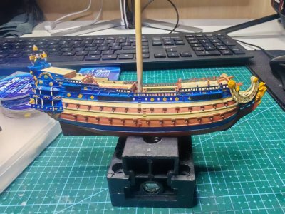

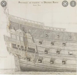

Most of my ship energy has been spent in collaboration with my friend Eric Wiberg and his Soleil Royal 1671 build. Eric’s journey with this model has been fascinating because it began as a resurrection of an old un-finished effort that, through several complete re-starts has focused into what I think are the limits this kit can be pushed to.
Not only has he re-configured the armament to match Winfield and Roberts’s citation of her launch artillery:
But he has introduced wale sheer that is appropriate for the 1670’s, which will later convey up into the top-sheer:
The DR of 1668, for comparison:
The more recent draft of this model developed a catastrophic failure of the upper bulwark joint, which motivated Eric to start fresh with a new hull, that he is properly planking with styrene between the wales and drifts. Below is the previous version, which was really coming along beautifully:
His latest effort, though, will really hit so many marks.
As I have always had to do with my project, Eric has found novel ways to play with perception of scale, in order to minimize some of the inherent flaws of the kit.
He has used a graduation of wale widths, together with discreet adjustments to the artillery height, and accurately scaled port openings (lid stops not yet installed) to very subtly reduce the apparent height between decks.
The beakhead will reflect the earlier Dutch style of the 1670’s. He has hand-made an entire series of heraldic war trophy ornaments that will run between the guns of the middle battery. The beakhead bulkhead is more appropriate for the times, and he has mastered the wrapping of the hull, past the beakhead bulkhead:
It has been a fun project to play with because Eric’s talent, patience and determination have shown me how much more is possible with the Heller kit. Even when I can’t be active, I really enjoy watching this one take shape.
