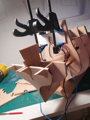

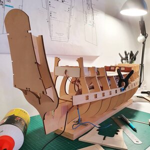

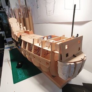

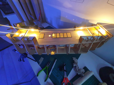

1. LEDs - I put them under the gratings, and there will be some at the stern gallery. I'm not using red/orange candle-like lights, but warm white. I'm not that much interested in lights looking realistic - I just want my model to be lit up. Warm white is a good for highlighting color of the surroundings and it's still a little yellowish so it does not look too weird.
The beakhead bulkhead has two openings (the upper ones) which in many models are used as gunports. In the DeAgostini model these were supposed to be windows, so I decided to stick with that. I drilled a hole in the frame behind this bulkhead so that the light could come out through these windows. I will make the windows of plexiglass, I just have to find a way to matt it because I don't want this interior to be fully seen.

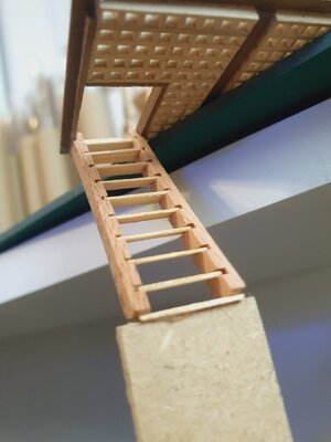

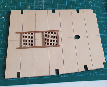

2. I didn't like the gratings provided with the kit so I replaced them and built them differently. I used Amati ones, and added walnut spacings.

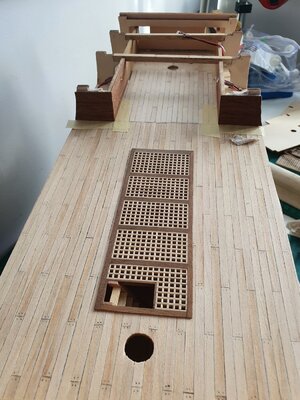

3. I will add gratings also on forecastle deck and put a capstan between them.

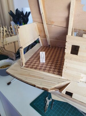

4. Bulkhead under the forecastle finished. It was suposed to be an open space, but I decided to try and make one. I took a terrible path and will never ever do it that way again. I used card as a base because, well, I have a lot of cards and modeling paper so WHY NOT? Now I know why It does not look as good as I wanted it to, but I learned a lot. I will add doors but after the work on hull planking is finished.

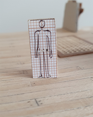

5. Meet Zdzisław Alien I made this guy so that I could keep track of sizes of things. I know that holes in the gratings are too big, but I decided to stick with that becouse of LEDs underneath. He is named after my friends grandpa, who passed away few weeks ago.

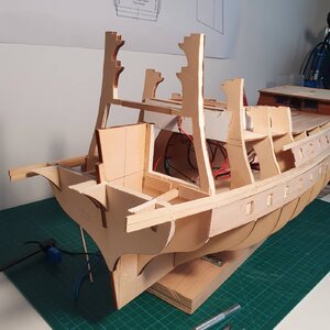

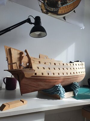

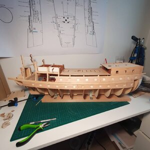

So I guess I know in which direction I want to go with that :) But I didn't do much during this week :rolleyes: I filled the bow with balsa, started planking the hull so I can see where gunports are located and I cut stern frames:

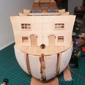

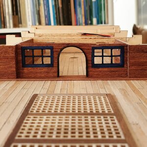

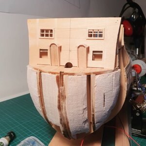

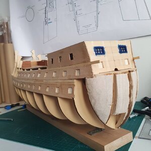

I was working a little on the beakhead bulkhead. I made windows (need to be sanded and stained with blue wood stain) and those fancy doors which turned out uneven - arc on one of them is lower, so I guess I need to do one more door...

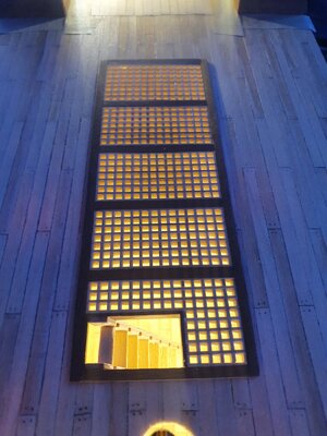

View attachment 271365View attachment 271367View attachment 271381

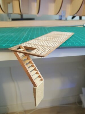

View attachment 271369View attachment 271371View attachment 271372

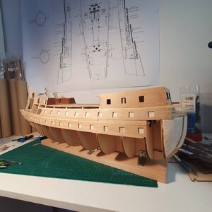

I've finished the first layer of planking and the second one on the bottom of the hull. I'm sorry I didn't post anything but this year I'm trying to kick depression out of my life and that drains a lot of energy out of me. I'm working slowly, but what's most important - I decided in which way I want to go with this project. When I started I was not that much interested in historical accuracy, but that changed. Not that I want it to be the most accurate model ever, but I want to enhance what I already did and if I'm doing something that most probably was not on the real ship - I want to be aware of it. I did a lot of research, read dozens of threads on different forums (long live google translator!), got my hand on a lot of books, etc.
And with all the information I got, I decided to cut out the windows I did on the beakhead bulkhead and cut out both bulkheads I did on the main deck.

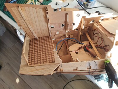

One of the three parquetries that will be inside the galleries. I decided to do more interiors than I planned, so I cut out a big hole:
and currently I'm working on how to arrange it :)
