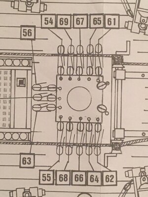

I guess they are set fast on the pin rails..This rigging diagram of blocks around mast is confusing. Where’s the line between blocks end u? Can someone please help? Thanks!
Thanks for the reply. 25 yr old Constructo Prince de Neufchâtel mystery. Probably not correct, but trying to get through it without redesigning everything. Thanks again for any help.A little bit strange sketch - which ship model / kit is this?
Maybe we can find out together

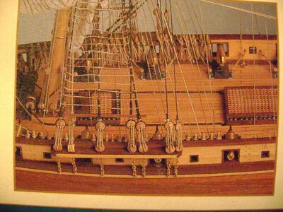

I found this photo of the box showing this part of the foremastThanks for the reply. 25 yr old Constructo Prince de Neufchâtel mystery. Probably not correct, but trying to get through it without redesigning everything. Thanks again for any help.
just seeUwes responce.I guess they are set fast on the pin rails..
That's a lot of pins!I found this photo of the box showing this part of the foremast

Yes - seems, that the complete running rigging was fixed on the siderail pinsThat's a lot of pins!
