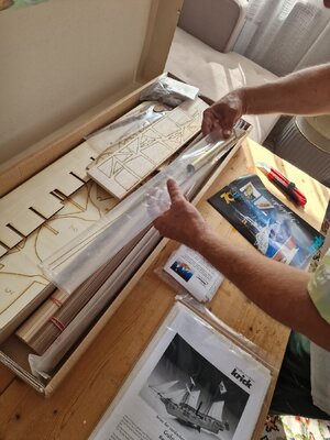

Собрался исполнить давнюю мечту. Пароход-фрегат с колесным движителем.
Good afternoon. Friends!I need help! SOS
I couldn't create a new theme because I'm bad at computers.
I'm going to fulfill an old dream. The steamer is a frigate with a wheeled propulsion.
Gulnara - 1/50 scale construction of a side steam ship​
Aviso of the Sardinian Navy. Built in 1834 in England and in the service in 1835 placed in the Navy of Sardinia, the Gulnara is a typical example of the Transition from sailing ship to steamship. The steam engine was at this Ship only as pure auxiliary drive. The ship was still full sailable.
As an observation, escort and passenger ship, the Gulnara did service for Sardinia until 1861. Then it was taken over by the Italian Navy. The Gulnara was with an oscillating steam engine from Fawcett & Preston, Liverpool, equipped. Part of the bike shovels could be sailed on ride to swive up to reduce the driving resistance.
Что можете сказать по этой модели?
What can you say about this model?
It is an attractive and representative model of the transition from sailing to steam. I would paint the hull in black and the deck elements such as cabins, skylights, etc. in white. Amati has brass decorations that would suit the ship well.
Cheers;)
Thank you. I'm also thinking about coloring and improving the design. It's interesting about Amati, we need to look for it. The kit has not been delivered to me yet, after receiving it, I will sign its composition and recommendations. I will ask for advice on improvement!
Спасибо. Я тоже думаю об окраске и улучшении дизайна. По Amati интересно, надо поискать. Набор ко мне еще не доставлен, после получения распишу его состав и рекомендации. Попрошу совета улучшении !
IS THERE A LINK TO THIS, IS IT A NEW KIT OR HAS IT BEEN AROUND IS THERE A PRICE. GOD BLESS STAQY SAFE ALL DON
I've been looking for something like this for a long time. My friends suggested it to me. I think it's been a few years

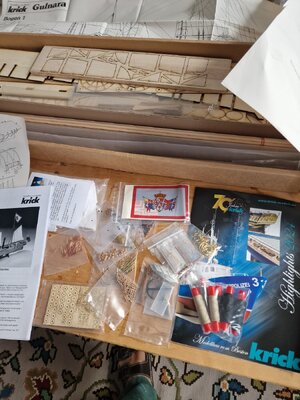

Добрый всем день!
Я получил эту чудесную модель. Мне требуется помощь Вашего разума!
Планировать ли окраску корпуса?
В какие цвета и пропорции?
Как можно улучшить вид и какими деталями?
Пока внимательно не понял как формируется кормовая каюта?
Может подумать сделать свет?
Любые Ваши пожелания!!

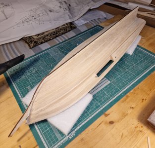

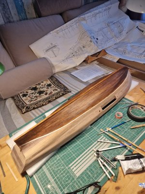

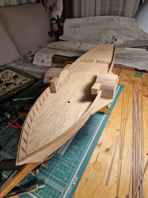

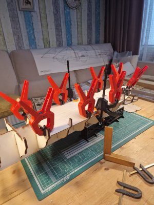

Процесс пошел. Почти закончил первый слой обшивки. Есть ошибки чертежей, но это решается внимательностью и проработки плана строительства. Определился с цветами и схемой окраски. От электрификации пришлось отказаться, после анализа конструкции и мест применения фонарей. Работа не стоит того. Все по плану.
The process continued. The first layer of cladding is almost ready. There are errors in the drawings, but this is solved by thoroughness and development of the building plan. I have decided on the colors and the color scheme. After analyzing the design and places of use of the lanterns, electrification had to be abandoned. The job is not worth it. Everything is going according to plan.

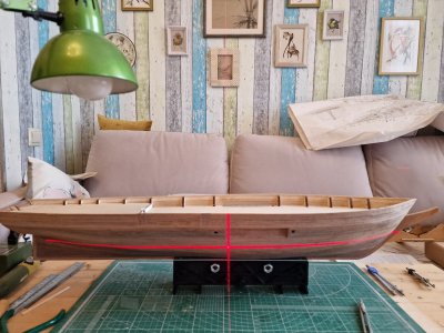

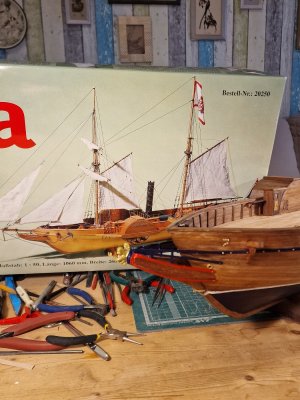

Закрытие очередного этапа. Чистовая обшивка корпуса модели. Подобрал планки в основном по оттенкам цвета. Затем очень захотел сделать ватерлинию. Следующий шаг тонировать подводную часть, может и получилось не так как хотелось, решил так и оставить ( покрыть лаком потом , как высохнет).
Для киля модели сделал коробок, не поддался на уговоры инструкции.
Closing of the next stage. Finishing of the model body. I picked up the bars mainly according to the shades of color. Then I really wanted to make a waterline. The next step is to tint the underwater part, maybe it didn't work out the way I wanted, I decided to leave it that way (to varnish it later, as it dries).
I made boxes for the keel of the model, I did not succumb to the persuasions of the instructions.

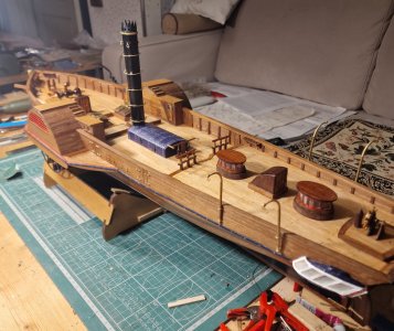

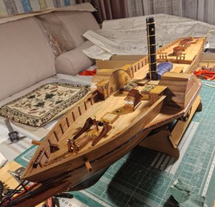

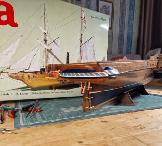

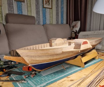

Сложно остановиться и сделать фото, хочется что то законченное показать.
Как видите концепция окраски изменилась. Предыдущая версия тонирования меня не удовлетворила качеством, не смог довести корпус до приемлемой частоты. И родился подход по цветовой гамме, все цвета с флага страны. Но не могут быть сардинцы быть скучными.
Пришлось конечно помучиться с исправлениями несоответствий разных чертежей и моих ошибок, как то справляюсь. Конечно присутствуют улучшения, это по моему мнению и решению.
It's hard to stop and take a photo, I want to show something finished.
As you can see, the concept of coloring has changed. The previous version of the tinting did not satisfy me with the quality, I could not bring the case to an acceptable frequency. And the color scheme approach was born, all the colors from the country's flag. But Sardinians can't be boring.
Of course, I had to suffer with correcting inconsistencies in different drawings and my mistakes, somehow I cope. Of course, there are improvements, this is in my opinion and decision.

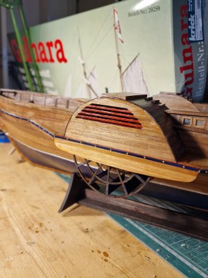

Я со своей помощницей Молликом Поздравляю Вас с Рождеством и Новым годом. Здоровья и гармонии в душе!!
Как видите мы поменяли дизайн разработчика, но нам так больше нравится!
My assistant Molly and I wish you a Merry Christmas and a Happy New Year. Health and harmony in the soul!!As you can see, we've changed the developer's design, but we like it better this way!
