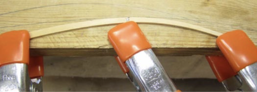

Not necessarily. It's possible to bend planks sideways in order to get correct shape. I've seen wonderfully planked models using this technique. All you need is template, which you'll need anyways, few clamps and some heat (hairdryer, iron ...)

In my view the strakes shouldn't be cut from wider stock. If you taper (spile) then edge bend the grain follows the line of the plank and will retain it's inherent strength. I always advise that if you follow the techniques and methods used in the shipyard you won't go far wrong. Gennaro is showing the best method. The forward end of the strake will curve downwards from approximately the third bulkhead See 'Planking the Winchelsea' on youtube.

One additional touch to a plank that has been spiled for width is to then do some gentle bending to assist it to take the curve inwards further removing stress when the plank is applied. Just a thought as it is not that difficult, even using only heat and some gentle finger pressure to try and dry-fit the plank until you are satisfied with the fit. Not always necessary to use moisture. I like to use Isopropyl Alcohol with only a couple of minutes of soak before wiping it off and using my electric bender which dries the alcohol out quickly without expansion of the wood. . . . at least as far as I detect things. Just a thought. PT-2 (Rich)
